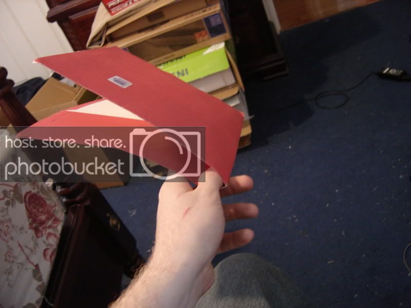

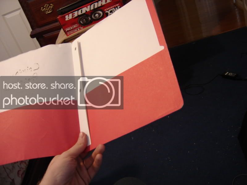

Just build shims out of a folder or loose-leaf paper.
Plastic sheets work well also.

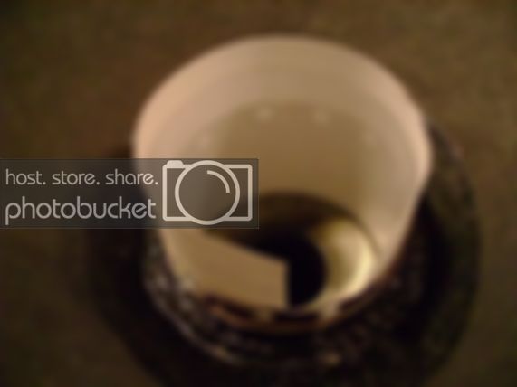

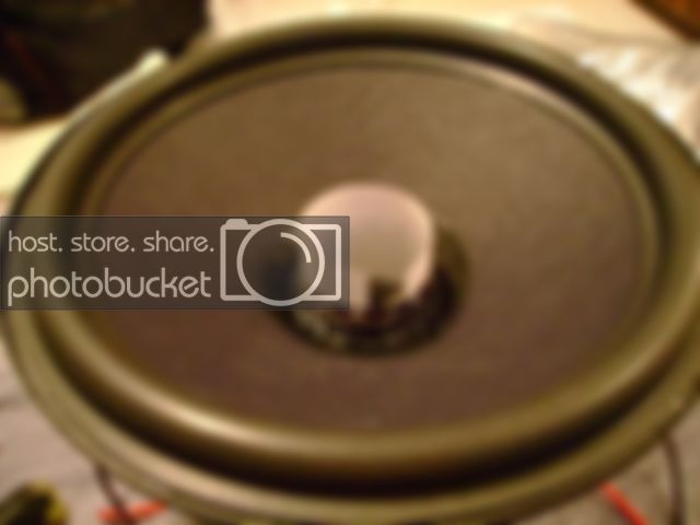

Just slip then in the gap between the VC former and pole-piece.
There is how I did my DD9515d:
Leave the shims in until the glue sets.
I have used Manila folders on some subs. But like what was said above, some gaps are closer than others. A few sheets of paper cut right and stacked on one another works great. That way you can build up the thickness you need.
