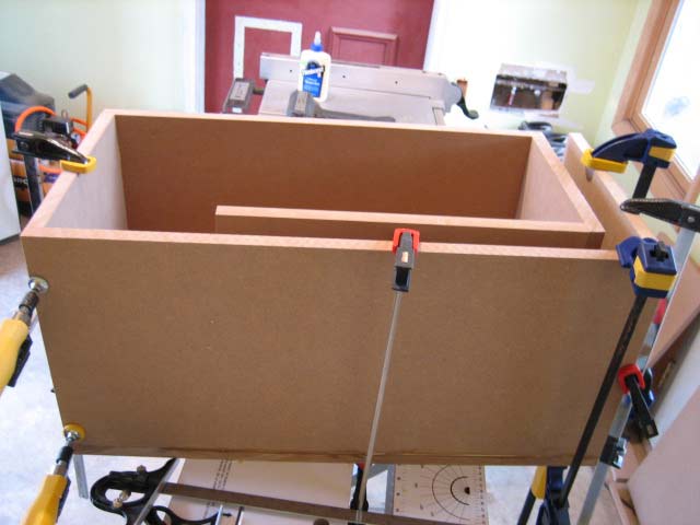

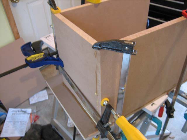

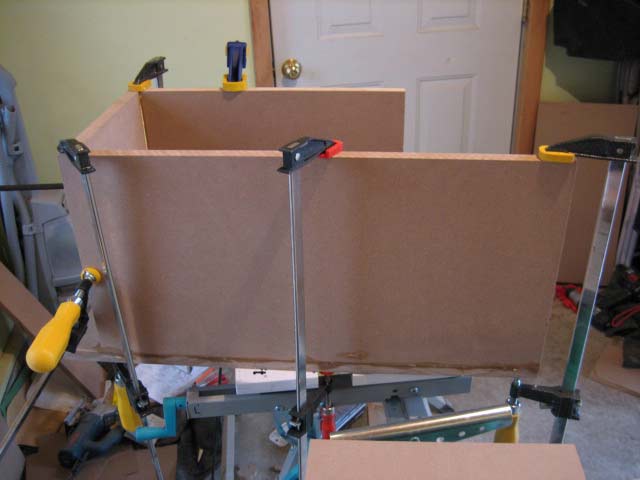

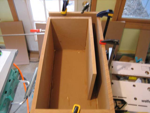

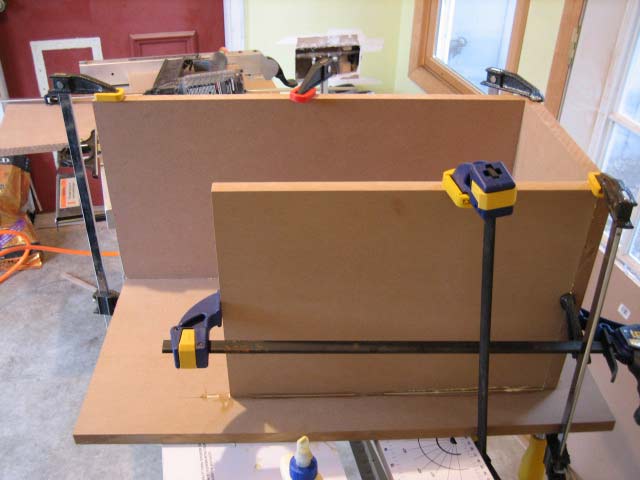

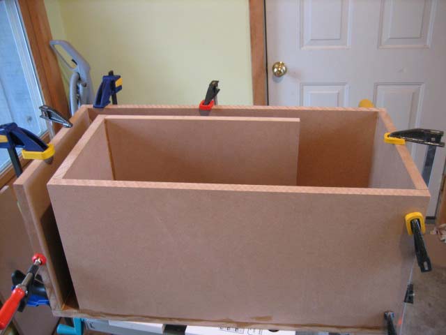

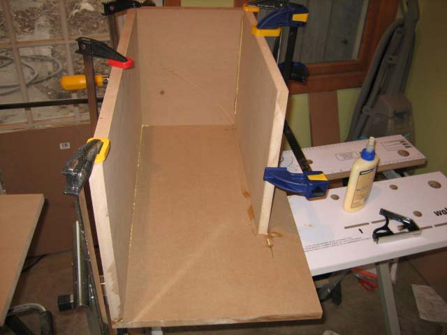

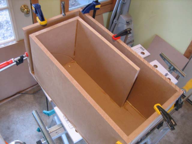

Here it is so far
lookin good. still have all your fingers? JK. looks like port piece 1 got away from you a bit on the table saw.
yep, everyone survived though //content.invisioncic.com/y282845/emoticons/smile.gif.1ebc41e1811405b213edfc4622c41e27.gif
Wow!! this box is SOOO much better than that sealed.. holy shit it pounds now.. very happy //content.invisioncic.com/y282845/emoticons/smile.gif.1ebc41e1811405b213edfc4622c41e27.gif Now I need to figure out what to do with my amps again.. had an amp rack made but now won't work with new box.. thats a job for tomorrow I guess.
