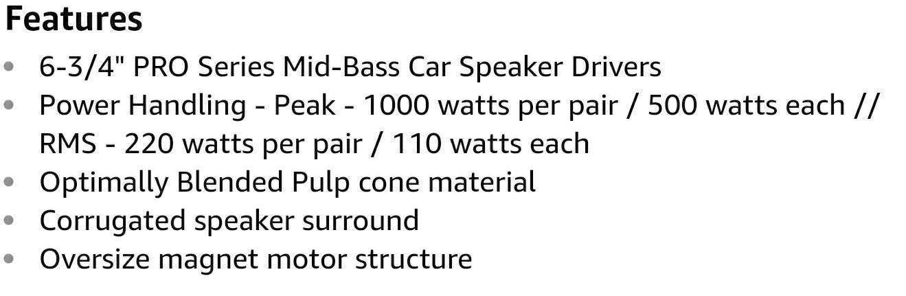

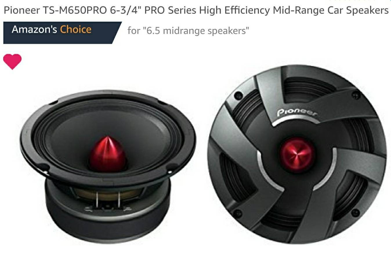

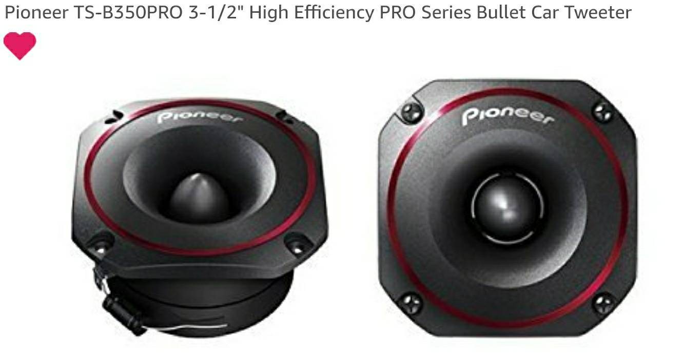

For the moment I ordered 4 Pioneer TS-M650PRO 6-3/4" Pro series High Efficiency Mid-Range Car Speakers. Also a pair of Pioneer TS-B350PRO 3-1/2" High Efficiency PRO Series Bullet Car Tweeters.
I would like to know what size amp I should run these speakers to and how I should be wiring them? (Example 400.4 on a 400 rms with a pair of crossovers on one set of 6-3/4" and the tweeters ran to 2 channels and other set of 6's ran to other 2 channels).

Run the super tweets on the front channels of the amp crossed over at at least 3k hertz, run the front components on the rear channels with a 60-80hz highpass filter and run the rear components on the head unit rear power.
Honestly I would get rid of the super tweets and run a set of components active but that's just me.
The rear speakers don't need to be too loud head unit power should be enough or buy a 6 channel that's 75-100w x 6
