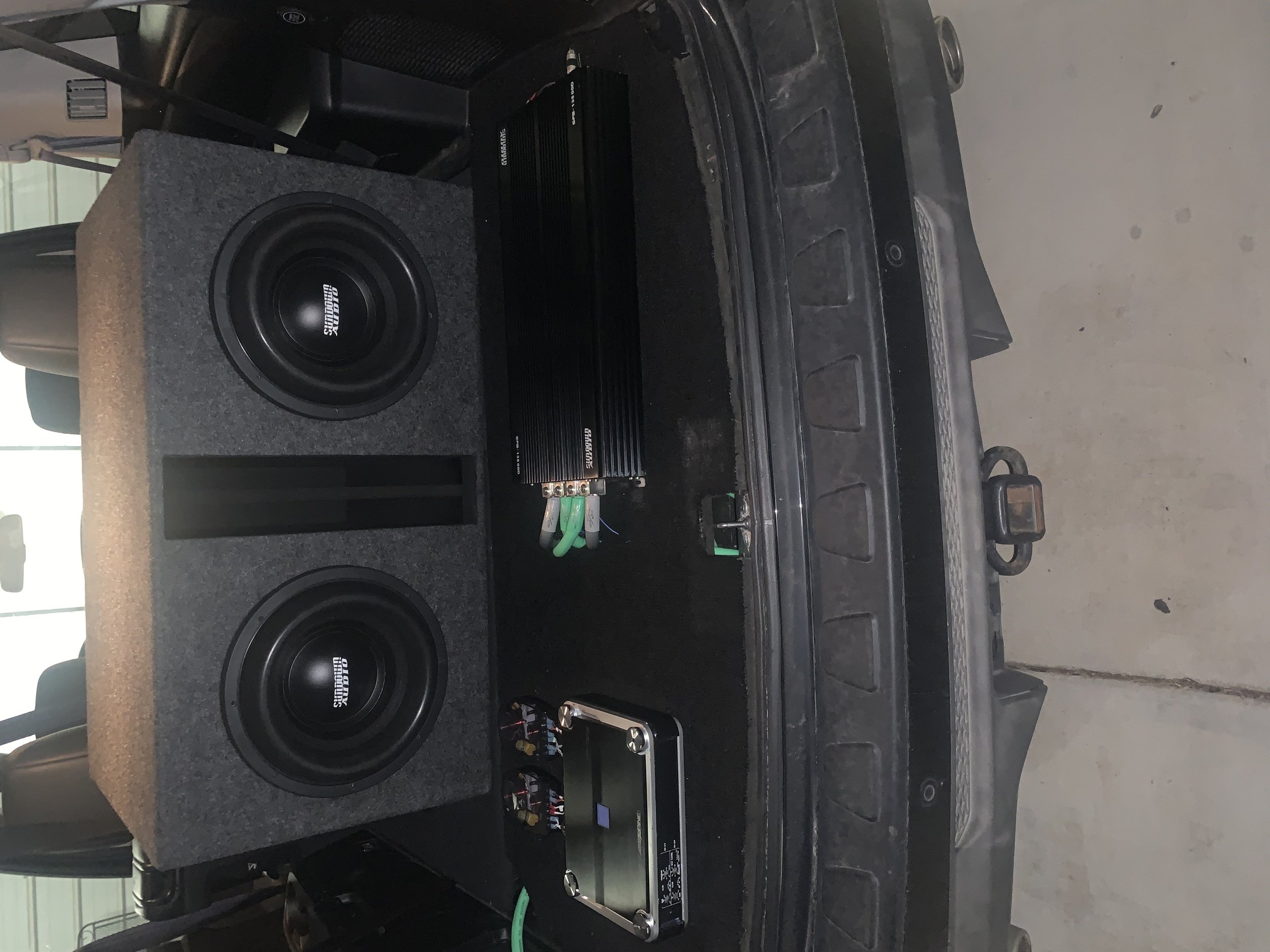

Here is a picture of the back setup. The XS D7500 Battery along with distribution and such are mounted under the wood I cut out. I put that carpet over the wood and mounted the amps on it.
curious how the gains were set?
Around 40%. I did not use any tool of measurement to set the gains. The 2015 pilot didn’t give me option much for a aftermarket stereo so I kept the factory stereo and installed the JL fix 86 processor. I did let an audio shop handle the tuning of that.
Hey thanks for the kind words. The subwoofers are Sundown X12’s V3 D2, wired to a 2ohm load to the Sundown 13,500/1 Monoblock amplifier. The gain is set around 40%. The enclosure is stage 3 dual ported mdf. I went for an in between kind of thing. What I mean is all types of music still sounds pretty good, but if I want to crank up the bass some to get that old school loud bass going I can. The small amplifier is a 4 channel alpine PDX 4.150. It supplies 2 sets of JL Audio 6.5 C3’s.
As for right now I’m finished. If I do anything else it will be something added to my front stage. I wouldn’t mind brightening that up some but I’m not sure how yet or what route I’d like to go. I’m not disappointed with the C3 performance but I think I want a little more umpf up front. The goal is to be able to play pretty loud without distortion. The ultimate goal would be to accomplish serious SQ while also being at a high listening level.
