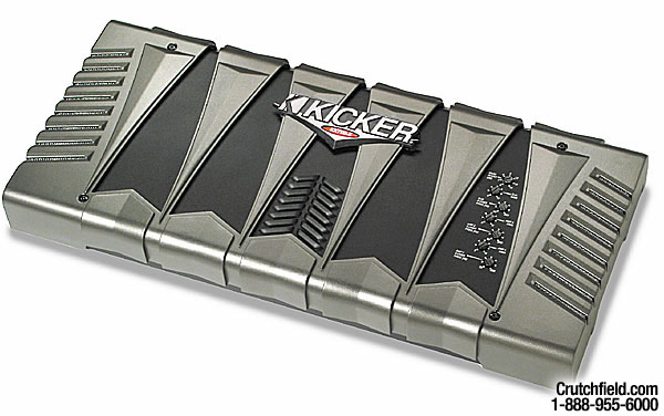

Okay, i just picked up the Kicker KX700.5 for pretty cheap, its beat up but works. When i checked the specs, i get different answers. My main question is this, can i run the 4 channels in 4 ohms, and the sub in 2 ohms? i dont have the pretty case, just the amp.

this is the amp btw

wow, thats good to hear, this amp is really beat up externally, but powers up like a champ. i need to test the other channels though, only tested the sub.
