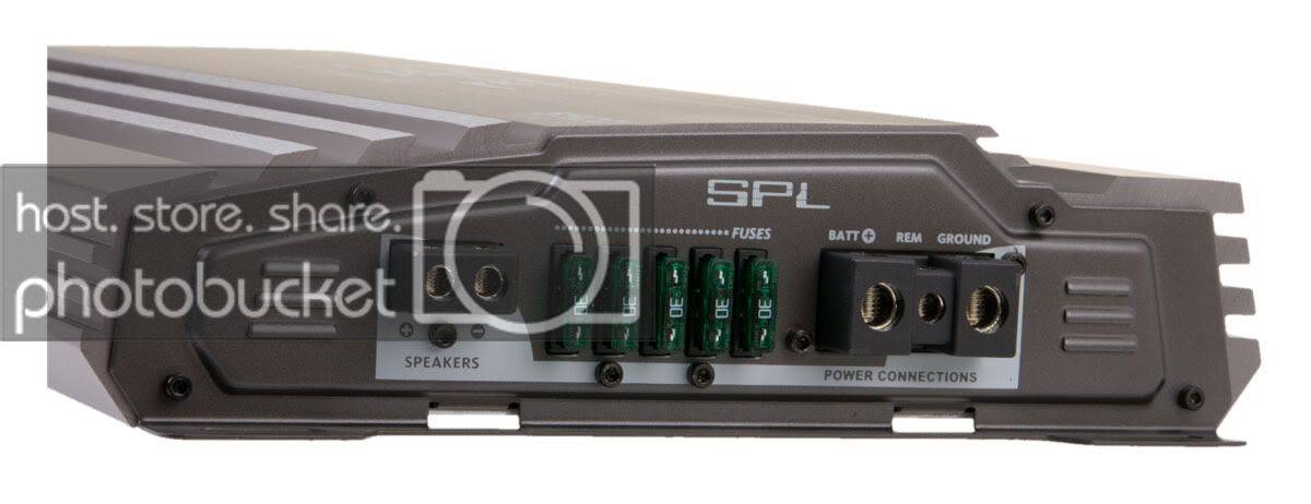

help wiring 6ohm subs
It should give you about 1500-2000 or so I'm guessing. Should be plenty of powa to get those Audiobahns moving. I've got an older MB Quart PAB 1200.1 and it does 1200 @ 1 ohm. It's got 2 60 fuses. That should tell you a little something anyway... By the way if you wire the subs in parallel you'll end up with a 1.5 ohm load.
i have 2 dual 6ohm audiobahns and a spl 5500 whtts class d amp the subs are 1000whtts rms each and at 4ohm load on amp it will put out 1700 whtts i need to hook them up either at 4 ohms if possible or 3ohms thanks for the help
wire them parallel and you will be fine, if the amp does happen to make 1500 watts at 1.5, it won't matter. Just do the box to specs.
