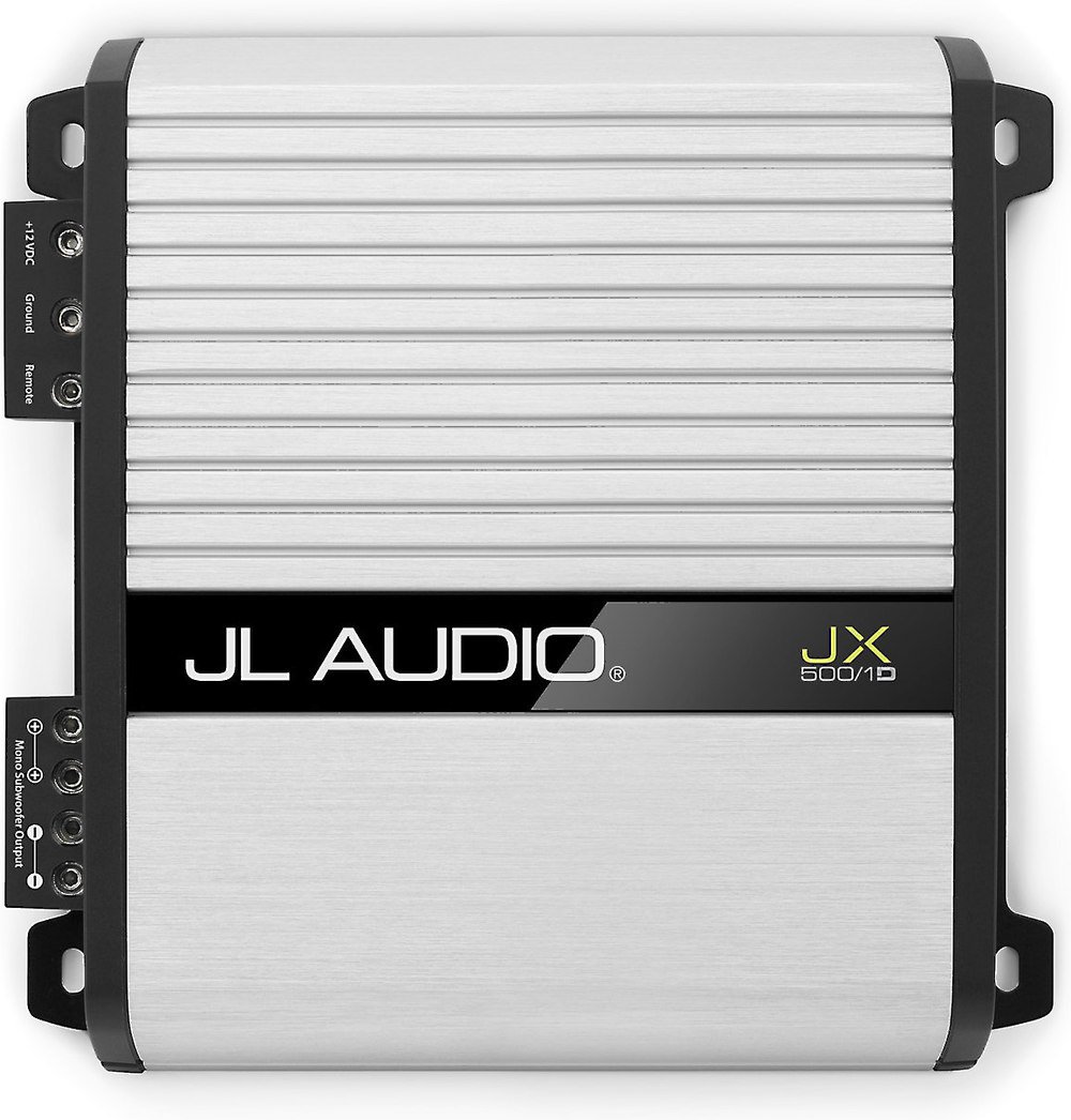

I found this amp... Jl Audio Jx500/1d Mono Subwoofer Amplifier - 500 Watts RMS X 1 At 2 Ohms is that good for power up my subs?
http://ecx.images-amazon.com/images/I/71jTOAIHj7L._SL1046_.jpg
If you want to run 2 of those Alpine speakers, like mylows10 said - find an amplifier that will put out enough RMS power for two of them, or maybe even a little more. You've got a great budget for that size of an amp, so your window is pretty wide. Find an amplifier that is rated at 1000 or even 1500 watts RMS at 1 ohm, if you're going to be running a pair.
