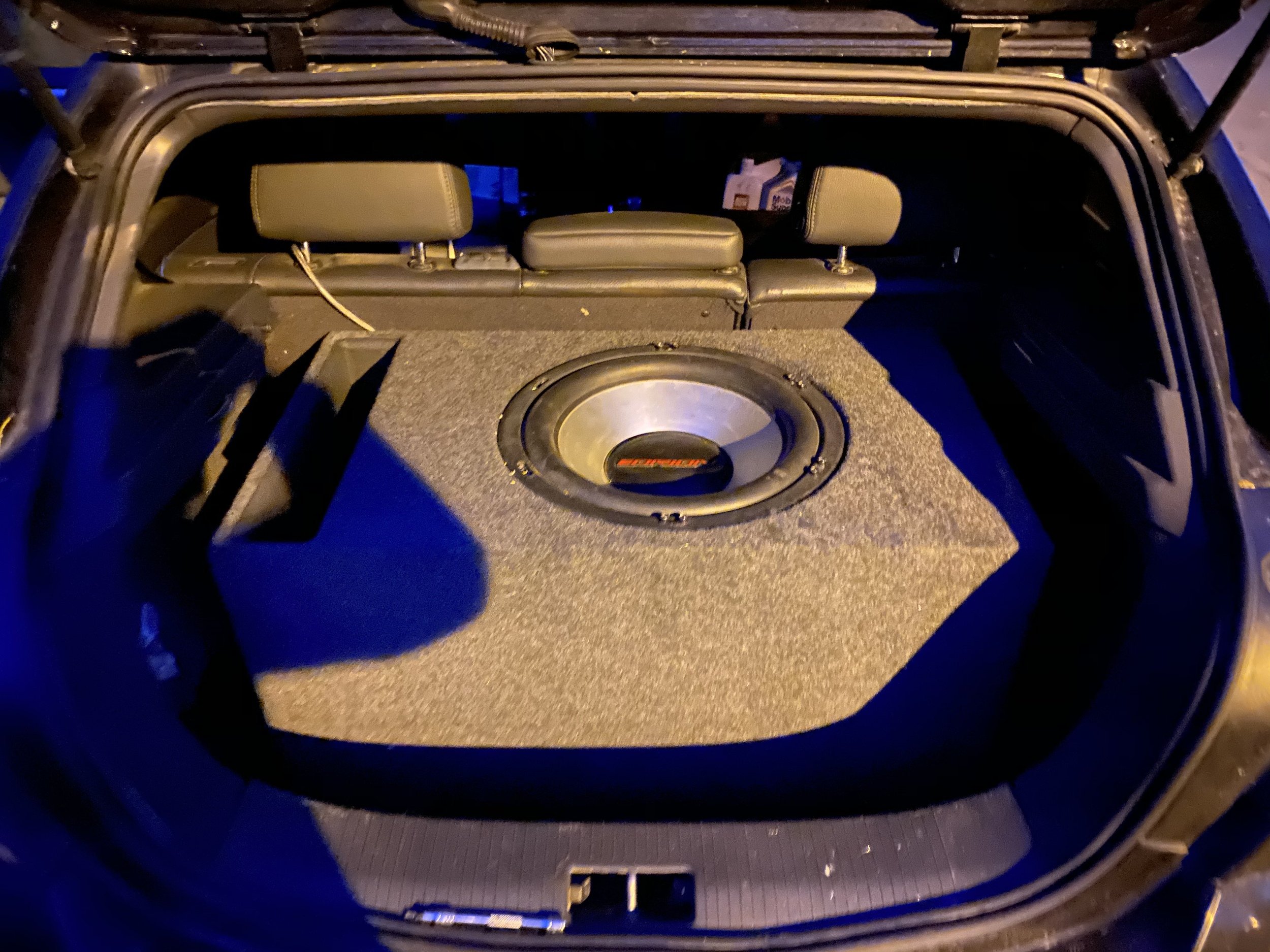

I’ve got a single Orion H2 15” 2000w rms wired down to 2 ohm with a Orion XTR PRO 2400@2ohm. I’ve run an extra battery to the boot, 70mm2 power earth for second battery and amp. Using a visual ice custom ported box tuned to 29hz. I’ve got a couple of questions as I have 2 of these subs, first one started smoking and smelling real bad. No crunching when pushing on the cone and still reads 2ohm however at low volume the speaker is popping and sounded real bad. I’ve now pulled that sub and replaced with my other one.

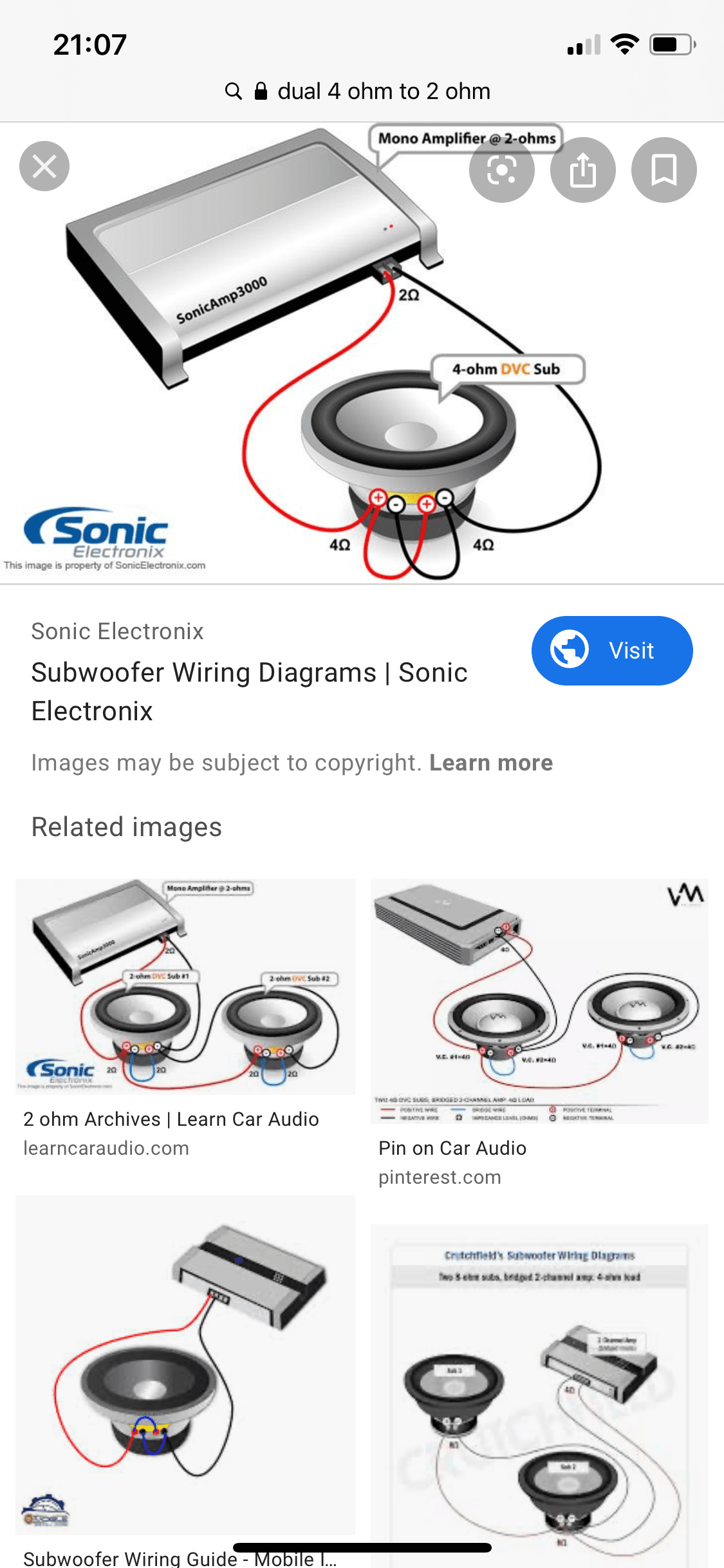

Wired down to 2 ohms. Both coils show two ohms on MM and 2 ohms on box terminals, jumper from pos to pos and neg to neg then positive on one coil negative on other. As this diagram shows
Amp is Stable at 2400@2
Um.... I probably won't be the only person to tell you this but if BOTH of your coils say 2ohms then that sub can only be wired with both coils together to either a 4ohm final load or 1ohm final load. The only way you can run it to the amp so that the amp sees 2ohms is by only hooking up one voice coil to the amp... which would sound like ***.
It’s a DVC 4 ohm subwoofer, wired as the photo I posted shows a final impedance of 2ohms on each coil, then test with a MM to the speaker terminals on the box also shows 2 ohms. I only have 1 subwoofer.
