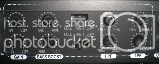

specs:
Rd Audio 50.4 4 channel amplifier
4 x 50W @ 4 ohms
4 x 85W @ 2 ohms
2 x 170W @ 4 ohms bridged

It looks to me like, since he has an HPF and an LPF on each channel, he can bandpass his mids using the amp. However, if your HU has the capabilities, which I believe it does, I think that would be the better option. Are you using any other speakers besides the one pair of mids and one pair of tweeters? If so, are you wanting to amplify them?

Ok, from the back of your HU you'll have two pairs of RCA cables (plugged into channels 1, 2, 3 & 4) running to your amplifier. Let's say you want to use channels 1 & 2 for your tweeters. Set the crossover selector on channels 1 & 2 on your amplifier to highpass. Then turn the highpass knob all the way up to 2KHz. From the corresponding speaker outputs on your amp, run speaker wire to the tweeters. Insert the remaining RCAs into channels 3 & 4 on your amp.
The more I look at your amp, the more I think that you probably can't bandpass your mids using the amp alone. Why they used two seperate knobs for high and low pass, I don't know. But I'm assuming if you select "full" rather than "high" or "low" on the crossover selector, you're going to be getting the entire spectrum of frequencies. If this is, indeed, the case, you have no choice but to set your mids at a high pass as well if you are only using the amp as a crossover. On channels 3 & 4, select high pass and turn the knob to 80Hz.
Now, you're going to have to use your HU to prevent all the really high frequencies from coming out of your mids. Go through your menu and find where you can select crossover points for channels 3 & 4. Use your HU to set a low pass filter at 2KHz. Of course, if I were you, I'd use my HU to do all the crossovers. Go to channel 1 & 2 crossover on the HU, set a high pass filter at 2KHz. Then you can (maybe) go to channel 3 & 4 and set a high pass at 80Hz (or 63Hz, or whatever works for you) as well as a low pass at 2KHz.

You can't set one crossover for channels 1 & 2 and then another for channels 3 & 4? Well, in that case set the amp like I suggested in the first two paragraphs above. Then go to your local audio store and get some inline lowpass crossovers for your mids so they don't get all the frequencies above 2KHz. Also, I'd be careful with the gains going to the factory tweeters. You might look into getting a budget friendly component set or looking on ebay for some aftermarket tweeters. I'm sure you could find something decent for pretty cheap.
