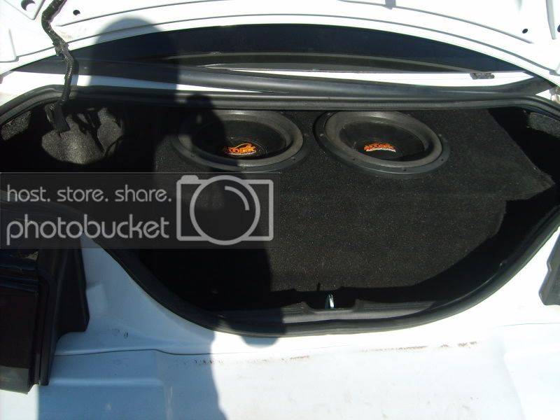

yea had a similiar design for 2 10s facing upward. i had a box that was 4 cubes. like 13.5X32X28 i believe. it was huge for my tiny trunk. i had to put it in length wise then turn it, after taking out my back seats and bending the borders back and using my feet to shove it in. and i think i chocked out my air space cause there wasn't room for shiat. lol
it fkin sucked!
