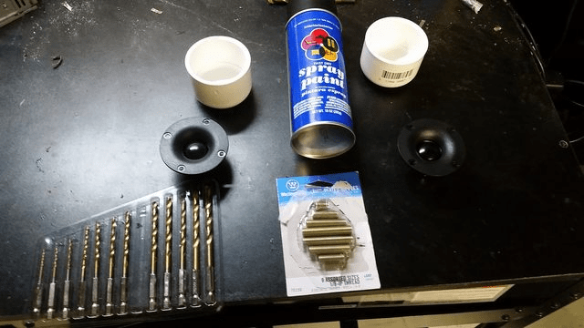

Does anyone have a solution to make the tweeters up front have better pointing, instead of at the windshield? Been trying to find if there is a small speaker pod for the tweeter anyone sells, I can probably make my own or modify something if I can follow what someone else has done. I can also 3d print my own if that’s recommended.
Many component sets have a nice pod type mount for tweeters. I know there used to be a Russian guy on this board who made custom mounting pods and grilles and suchlike out of machined aluminum that looked immaculate. If he isn't still doing it I'm sure someone else out there is.
As far as "good" sound, less is more. Good components in good locations up front and sub in the rear is going to be the easiest way to sound good. Anything beyond that will get you loud and you can make it sound clear, but you'll never get a proper sound stage mounting components behind you or all over the place.
I'd suggest doing JUST the fronts and the sub first and seeing how that goes for you, fill up the sound bar later if you feel you need louder but it will come at the expense of a good forward soundstage.

You can get pvc end caps and a hollow bolt (to feed speaker wire through) all at home depot for less than 10 bucks and you can install it in the a pillars or sail panel. Most decent tweeters come with pods though
That's a pretty decent and cheap way to do it. Thanks for the idea!
