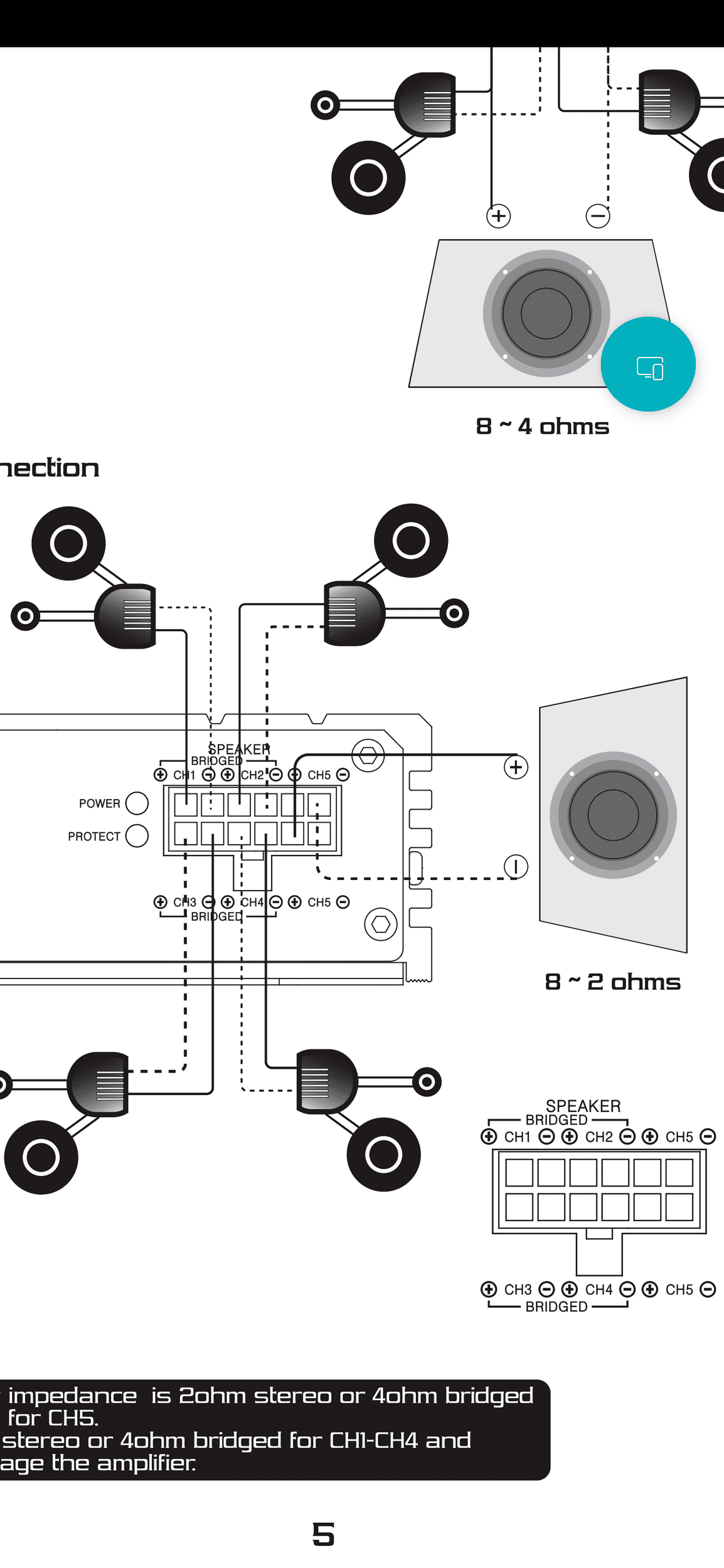

I’m trying to connect a Skar Audio SK-M9005D (5 channel amp) to four speakers and a single SVC subwoofer.
The 5th channel has 4 wires (2 blue and 2 yellow).
How to connect those four wires to the two terminals on the sun to get a 4 ohm setup?
Thank you for posting that, however I think the image is cut off?
Also, the part of the image showing the speaker wires, shows only two wires... There are four coming out of my amp (for just the 5th channel).
I should just connect two wires and leave the other two unplugged (capped off), in order to achieve full 300 watt rms @ 4 ohms, correct?
The two positive wires are one wire inside, and the two negatives are also one wire on the inside. Just twist them together and connect your sub to them. It will automatically know what resistance your sub is.
