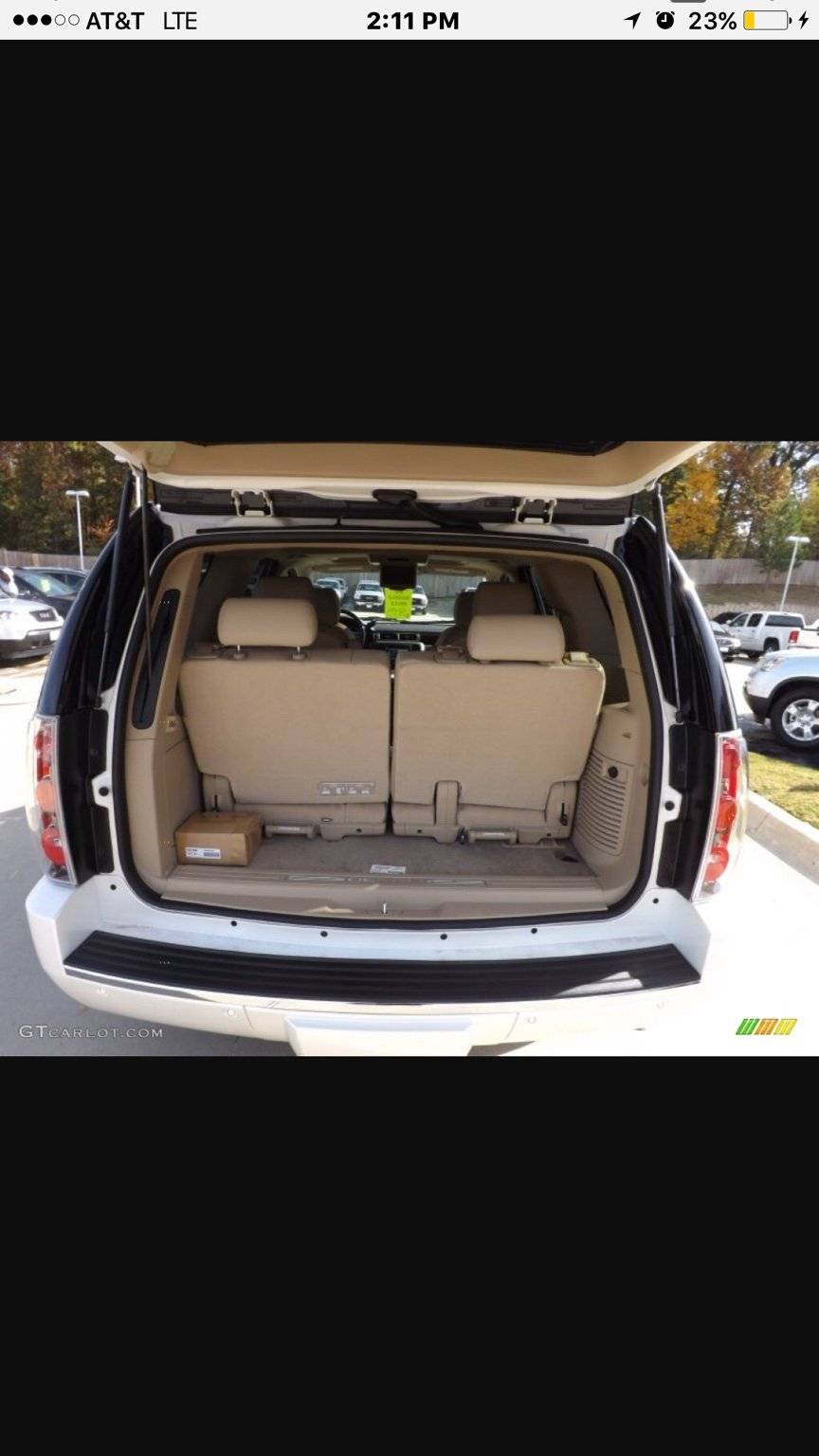

So I'm very limited on space now and have to down grade from 2 12"s to 1 10". My goal is to make a counter style box so I can still place my kids stroller on it, groceries etc etc. I have 48"w X 12" deep and as least as possible tall. I'd like to either make the sub internal so it's not visible with a side port or sealed if possible but the main goal here is build a good sounding box at approximately 34hz and that is like a counter. Can anyone help me design or with ideas ?

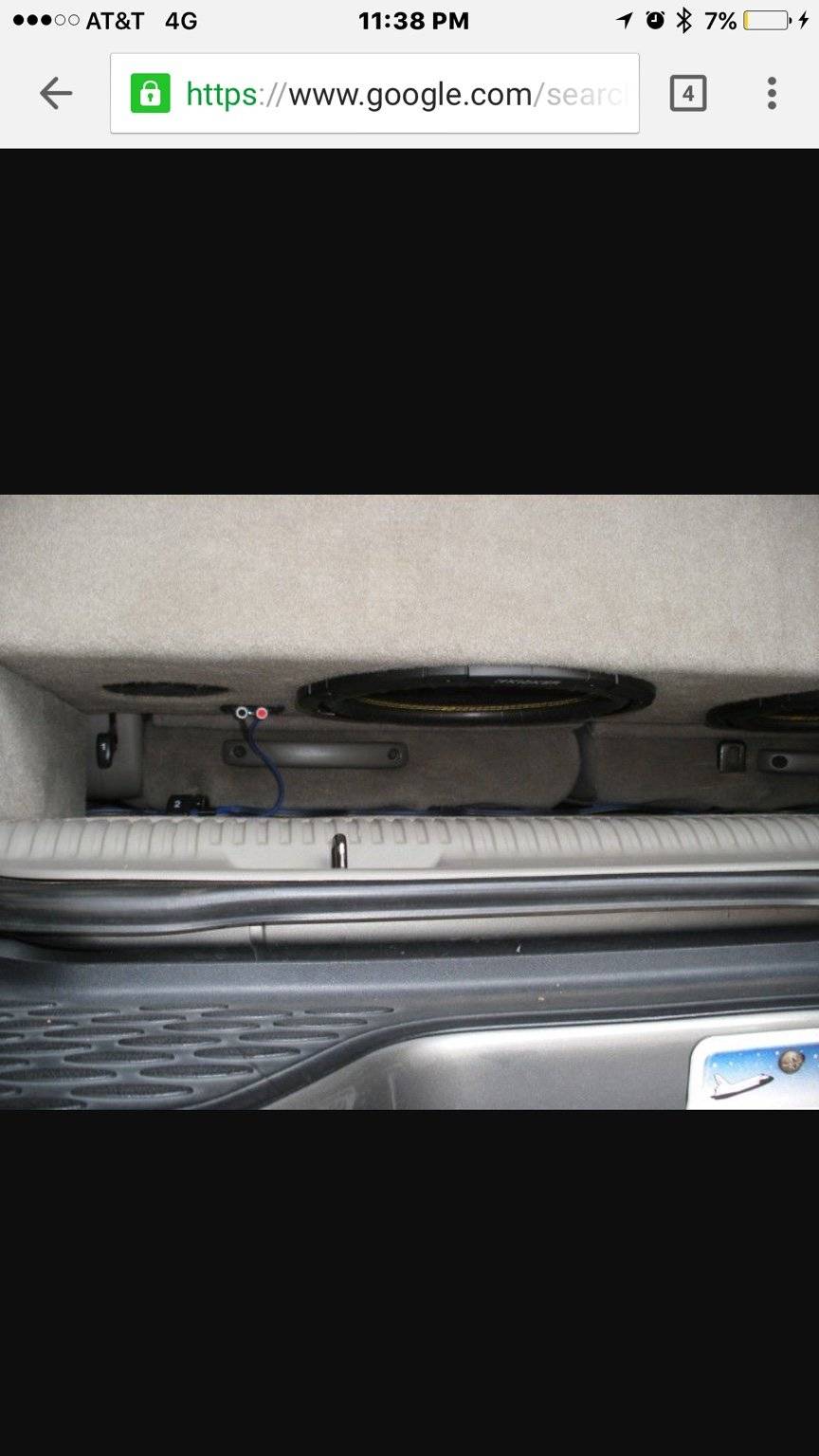

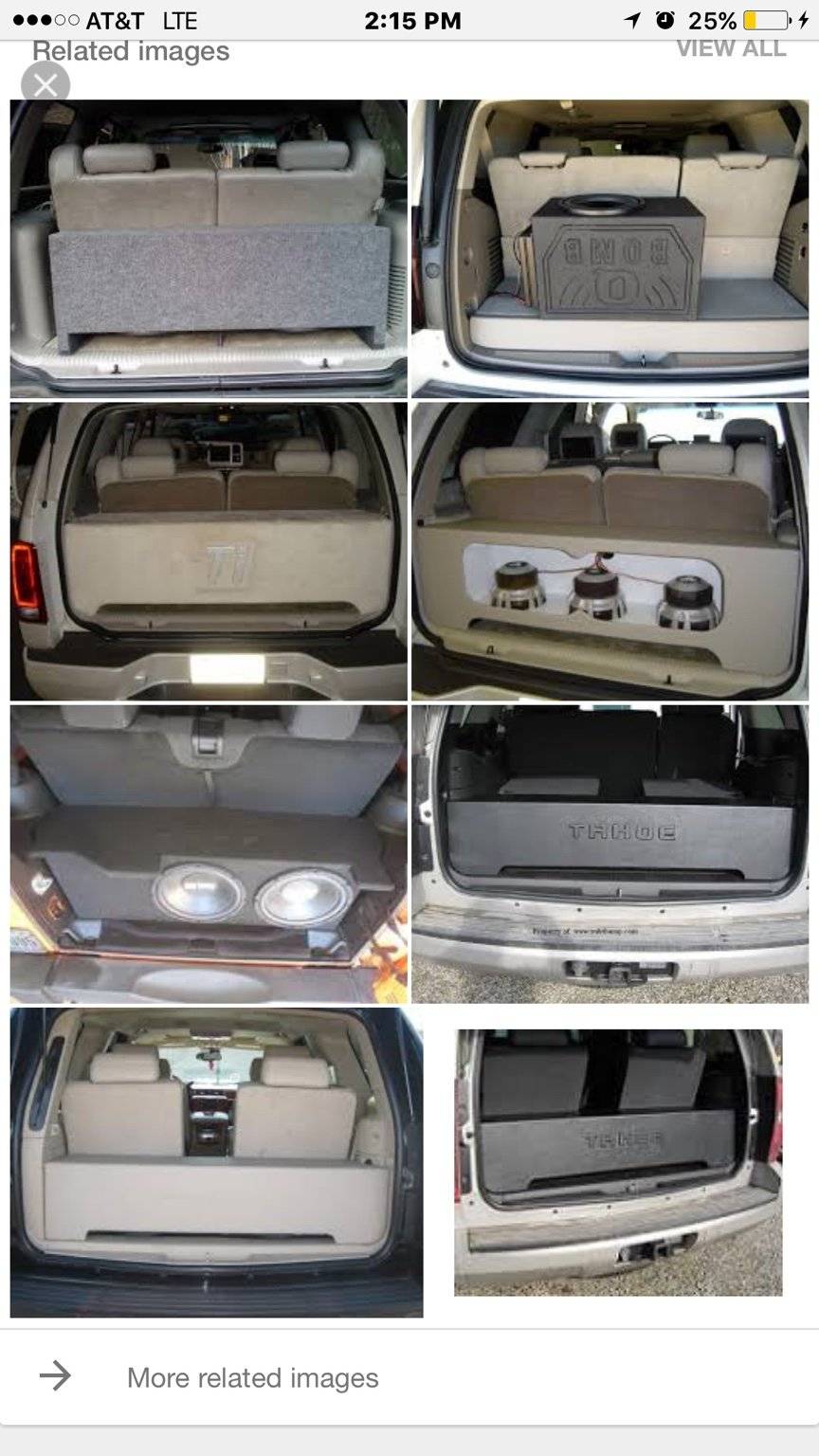

It looks similar to this
Another thought has been to make a box about 42" wide X 12" deep and maybe 13" tall and have one 12" on each end facing out towards the sides. Kind of like a bass tube except with a sub on each side. This way I wouldn't have to lose my 12"s and I'm thinking sealed cause they require less space. It would keep my counter short in height and hopefully sound good enough.

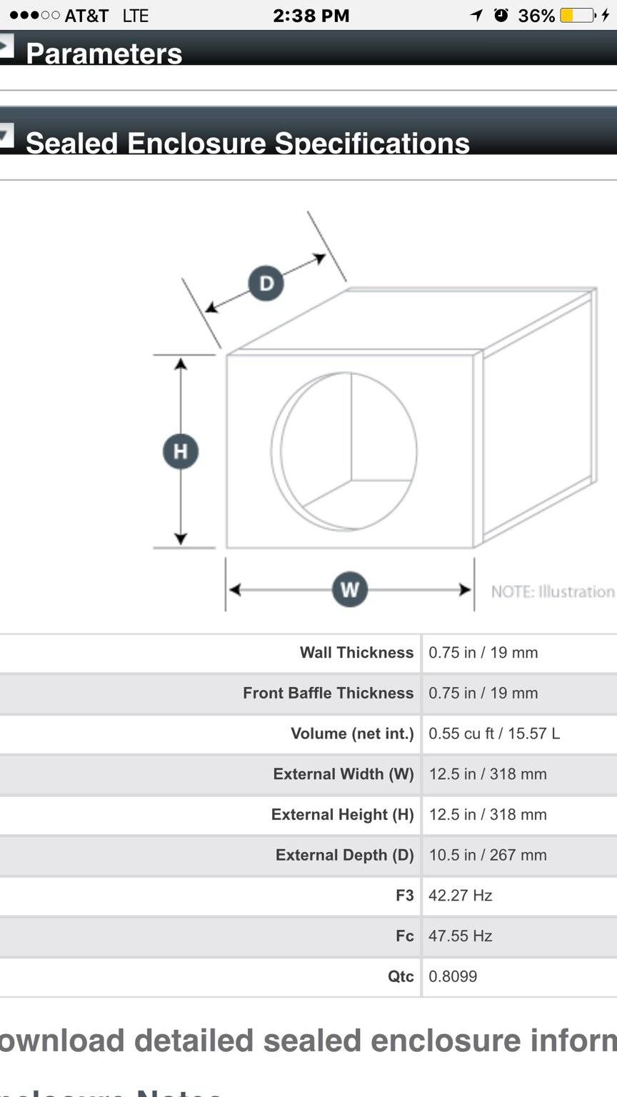

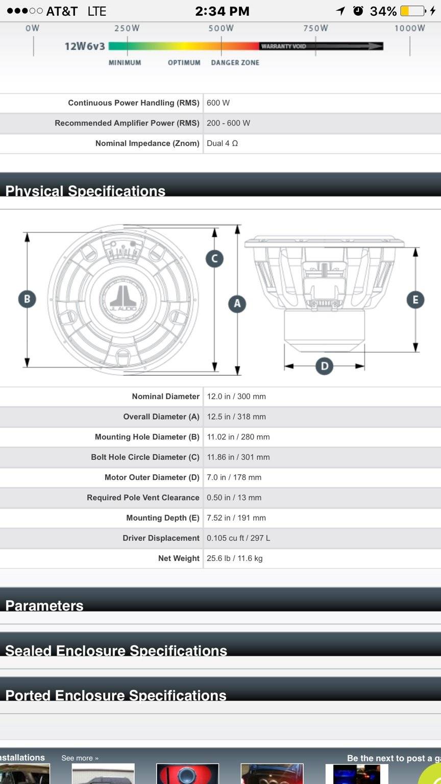

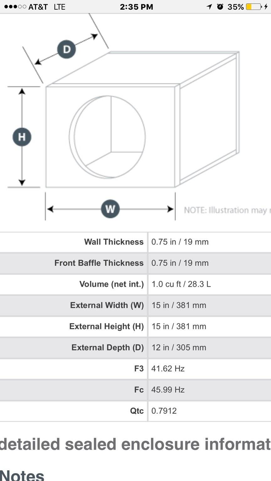

These are the specs for a sealed Ina single 12" w6v3 notice 41hz? I'd like a lot lower so would think that bigger sealed would give me lower.

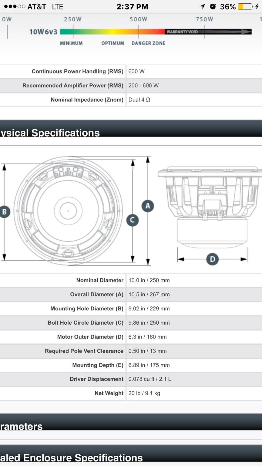

Here are the specs for the single 10". Again hz are high in my opinion. So would like make narrower and shorter yet wider .

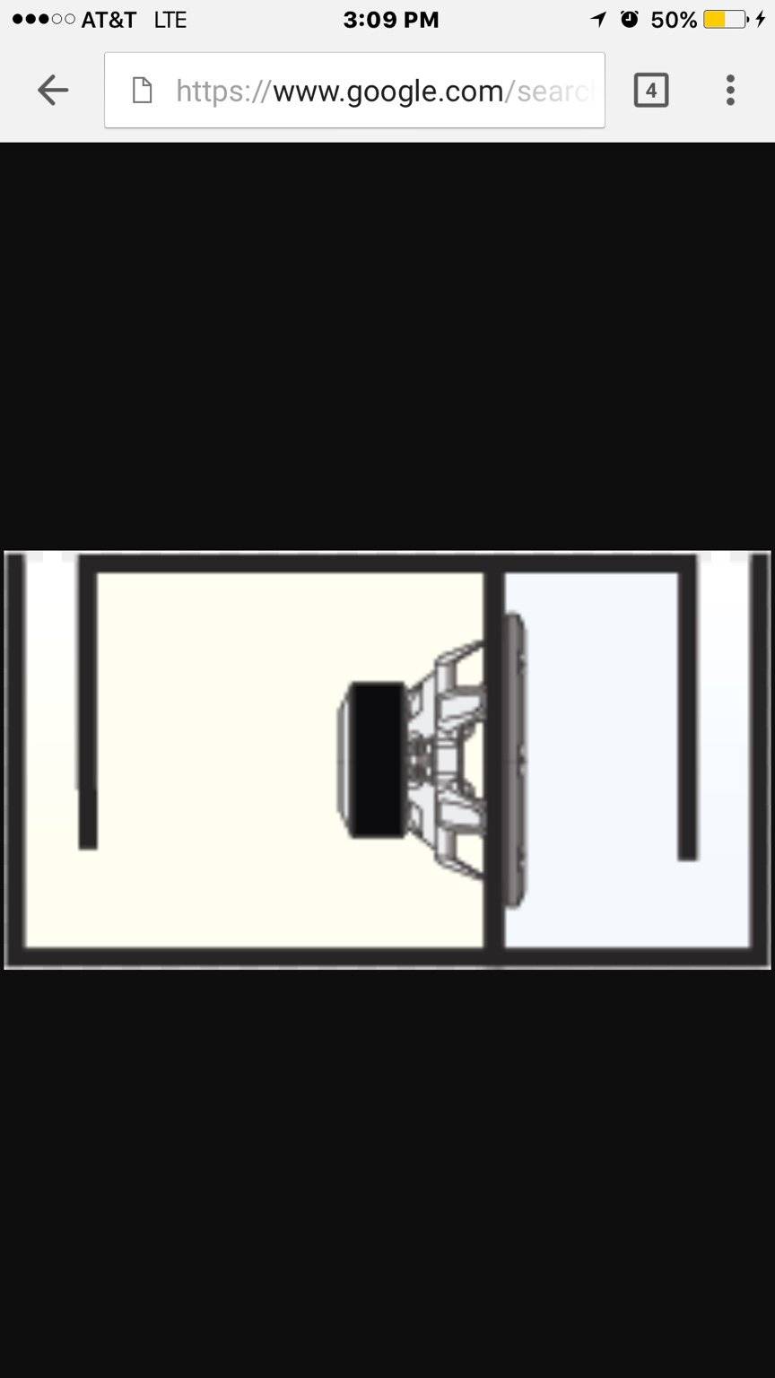

Something like this would be nice , I would just have to aim ports towards sides so not visible .
Looks good but I'm worried that if the sub and port are facing opposite direction, you might come across some phase issues. It might work since it's so close to the side walls but I still think it would sound better if they were facing up or rear. Hard to say until you try it.

So the plan is this , according to a box building program the dimensions given by JL for a w6v3 12" sealed equal out to 1.155 cubic ft. So if I go with 12.5x12.5x18 I get very close to what JL specs out. This will also fit in the truck and I won't have to sell these 12"s and downgrade to a 10". I'll update this post with pics once completed but it will be a while. I'm just making plans for now. Not crazy about sealed but it is what it is and if it sounds that bad I make a single 10" ported . Wish me luck
