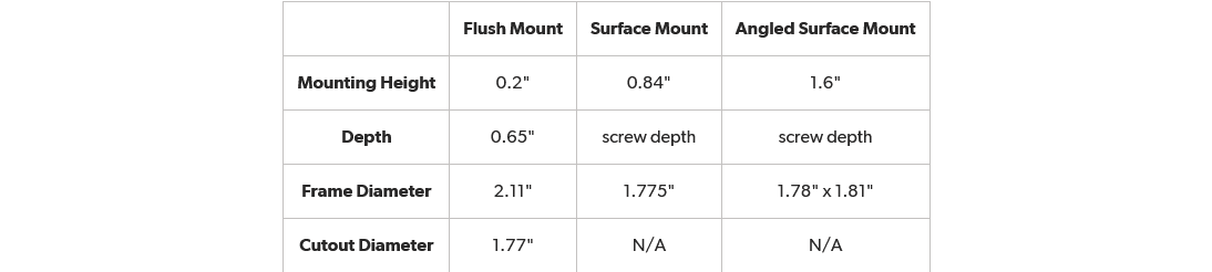

That should work for the 1st set you are looking for it has dimensions in it but won't have the pod info on it.

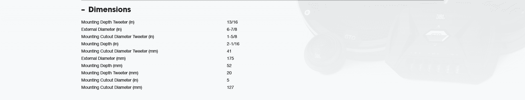

For the second set of JBL's this is on their us website.

I think he means dimensions after popping the tweeter out of the plastic housing to just glue it up into a factory location. It's not surprising that nobody you could get on the phone would know this as outside of R&D process who will know/care? It's basically asking the manufacturer "what are the dimensions of your product after I break it?"
I've done this before and just broken up all the plastic around the raw driver and used some glue. Not sure if I have any advice outside of just buy something cheap and start breaking the plastic away and hope it fits.
Thanks for the replies both.
I did find the docs you shared links to but they don't have the info I was hoping to find. The strange thing is that JBL & Focal docs clearly show that the tweeters are removeable from the covers (as they have a choice of which cover you can use) but don't give the bare tweeter dia - so (for these units) there's no need to "break" the tweeters out of the covers.
