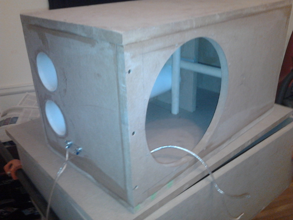

I just saw your other thread about removing the backseat and flipping your box around and someone had mentioned subs back, port to the side. If you go that route, I suggest building a larger scale version of this box:
You could definitely keep the width at or under 32inches and with a 36hz tune with 2 6in ports and 3.8cu/ft, the ports would need to be 26.5in long.
