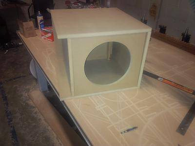

gonna attempt to build the sub box from 3/4 excel plus mdf..(more dense than regular mdf) using Sundowns specs ( 1.5-2.0 ft^3 @ 35hz)
I'm thinking of wiring the Sub for 1ohm... what would be the optimal setup/amp/wiring to get the most out of my sub
