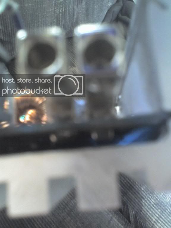

could this be the problem?
looks as if the solder on the right speaker terminal has been burned off but has no evidence of damage to the board
Whoa!!! That's a sign from God!

I put some solder on the peg and will be testing it out tomorrow i hope it works!!! I tested the terminal with a dmm. Before it was 32.32ohms and now its .890 ohms. I hope that has some significance.
