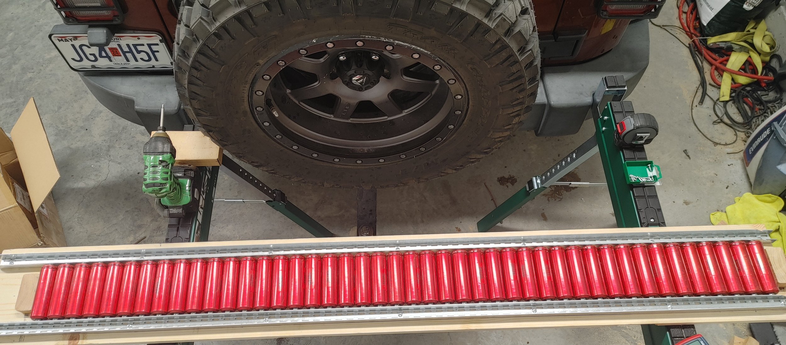

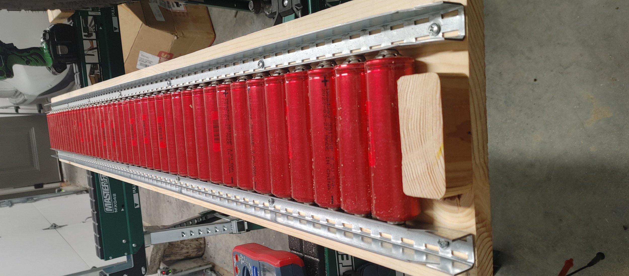

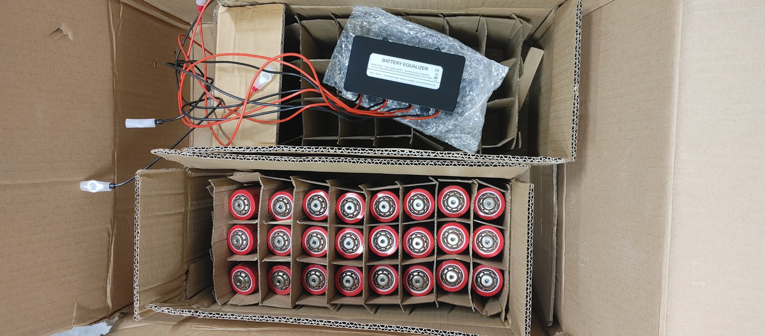

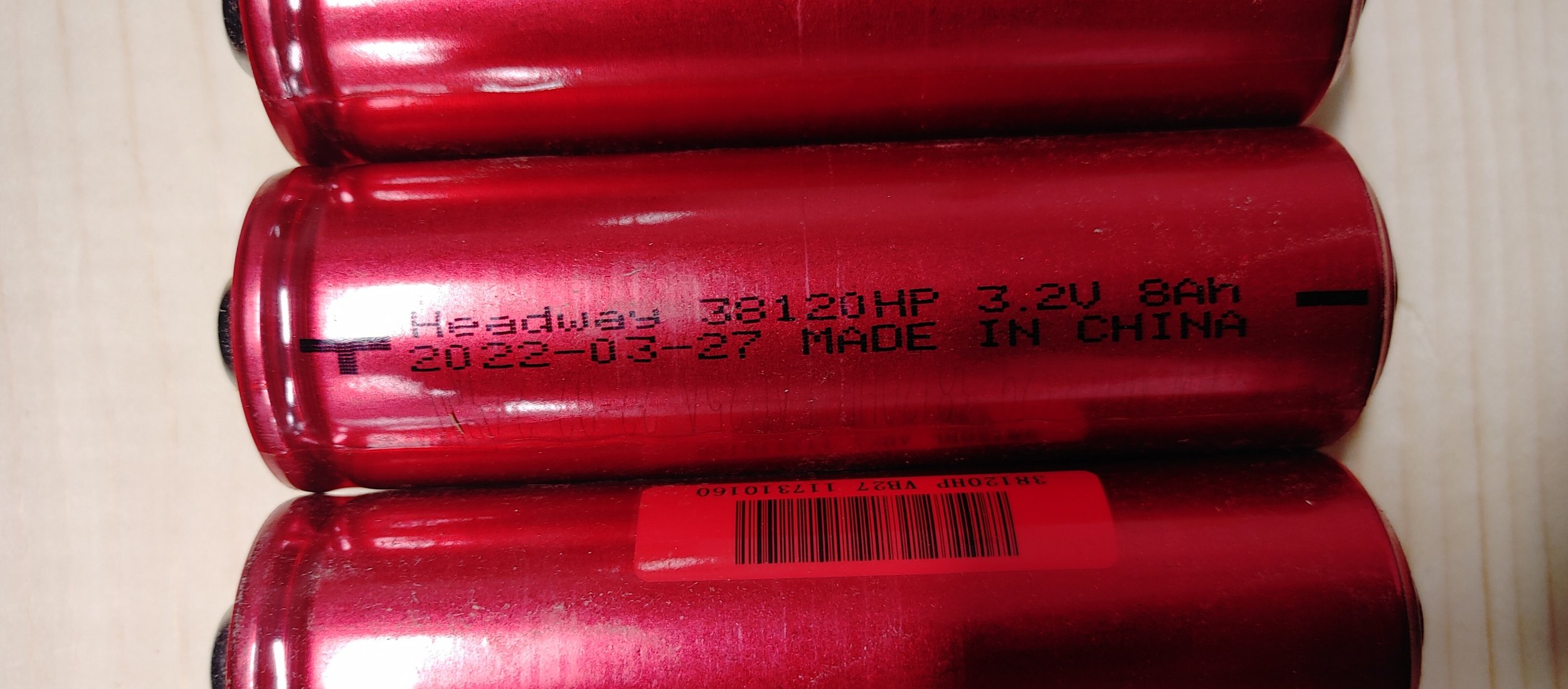

I ordered 44 new Headway 38120HP 8AH 25C 200Amp LiFePo4 Super High Power Cells and a HA02 Battery Equalizer from BMS batteries. I also ordered an 88 amp hour set of bars from project DB.
I've read about top balancing and all sorts of things. I would appreciate input from someone who 100% knows how to put one of these things together right cuz I don't want to screw it up!

Man!!!Id like to see picks of those when they come in!!

Will do.. I ordered headway and they shipped same day. Im working out of state so it will be a couple weeks before i get home... Not sure on the bars.. I ordered everything 5 days ago and no shipping confirmation frim project db yet.

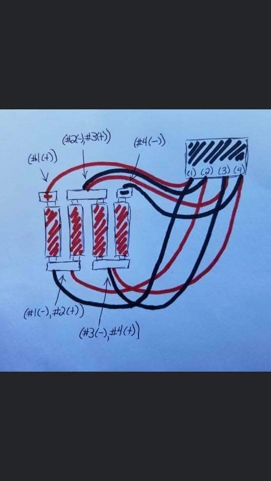

Ha02 balancer i bought didn't come with a manual. Do you know how to wire it up?
