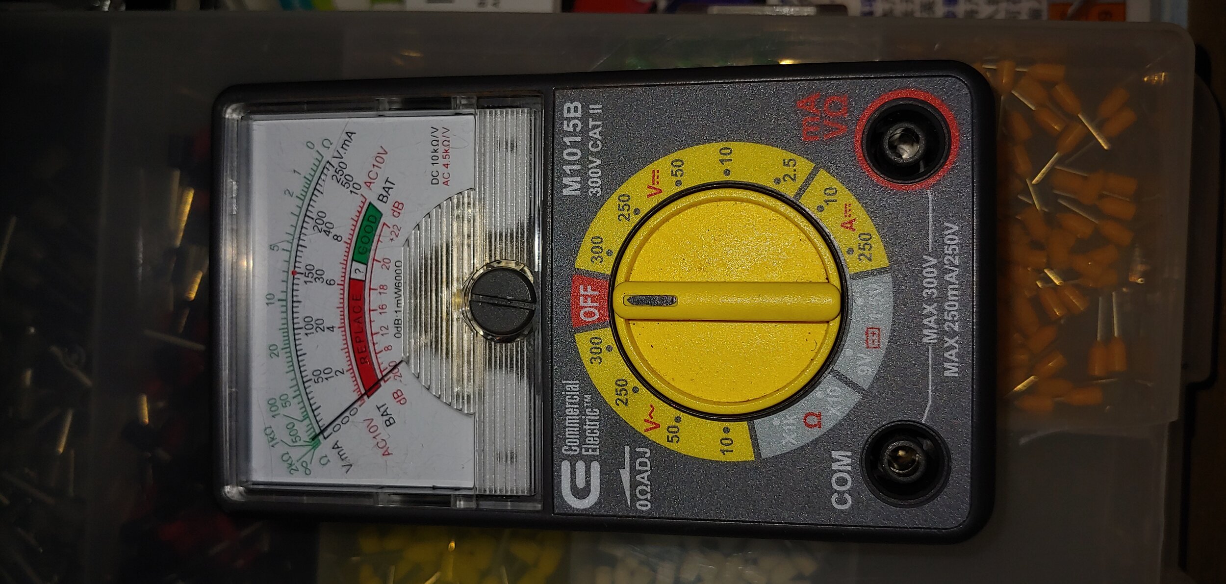

For this I use an analog multimeter. It moves instantly and backwards if connected wrong.
Measuring with the multimeter is just the DC resistance of the voice coil, which registers like a resistor, makes no difference which polarity you connect it and it will not show the polarity of a speaker. I haven't used an analog meter in a while, I do have some and used them for years long ago, but I don't recall them moving backwards during a resistance test of a speaker, would only see negative reading with DC voltage measurements.
For the woofers, NOT the tweeters as you can fry the tweeters, again the woofers meaning 6.5" or whatever they are, you can connect a AA battery to its terminals and watch the cone move outward, that is the correct polarity. You tap the wire to the battery and watch the cone move. If the cone moves inward that would be reverse. If they are 2-way OEM speakers you can still do this test as long as they have a capacitor inline with the tweeter as the crossover. Tweeters are easy to smoke with DC voltage.

Since stating the loss of the pigtails, I assumed he was referring to the radio wires. Turn on bass music and the peg will jump to the negative if hooked incorrectly. But the battery to speaker test is right.
Yeah wouldn't hurt to try if he has access to an older meter.
