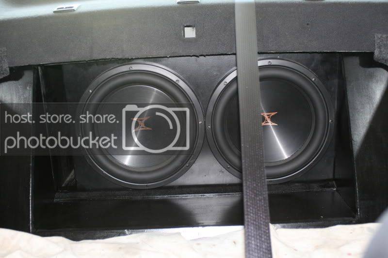

aright im just getting plain tired of my rl-p's now. justw anna try somethign different really and have the itch to try something new. currently runnign 2 12" rl-p 12's in a 3 or 3.5 cube box tuned to 32 hz
my setup is all front firing port and subs, i have aroudn 4 cube maybe 4.5 i can squeeze out of it. i will most likely be usuing 6" aeros or try for a kerf port if there is enough room but i dont think there will be.
now my question is how will a single 15 soudn compared to my dual 12's? all i have ver ran is 2 12's so i kind of want to try something different.
at first the hdc3 will only have 1500rms too it untill i get a new amp, then i will throw 2000 to 2500 to it a little later on.
any inout would help just trying to get something new in my ride, the rl-p's are kind of dissapointing me in a front firing enclosure not as loud as they used to be, so just need something different
its in an 05 sebring, this is how it is currently set up, goignt o be same way, but with a 15 and the front baffle of the box will have to be angled to fit the 15"
im still in designing stages and tryign to figure everything out, but i would like to know if it is goign to be louder and get lower then the rl-p's. if all the effort is going to result in less sound output then i am probably going to go another route.
right behind the fold down rear seats:

yea thats how ihave to do it, i cant have a box shape, need thwe front to be wedged its gonna be tight but after measuring everything seems it will fit, need to mock it all up and see if it will before i go about buyign everything but just tryignt o get some input from everyone to see if this is the route i wanna go

do you have any box plans? your gonna need atleast 3.5cf net, 4cf would be better. 16inches tall baffle and atleast 64 square inches for port area. which would make your port 14.5hx4.5w
