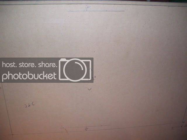

Alright. Heres what i am going to do..
You see the lines labeled 3/4".. Thats where the sides were going to be fastened, screws going straight down, but i think that ill put the sides on the outside instead, running screws inward and being conscious of my mounting cutout, so i can keep the full 17".
That sound better to you all?
Edit: The opening for the port is going to be 4in by 17in. So the area, at the opening, is showing 68in.... OK..
Code:
PORT 4.25 X 17 X 19=0.8ft³(72.25in² at opening)
BOX  24.25 X 24.25 X 16.25=5.5ft³
                         -0.8ft³
                         =4.7ft³ X 16=75.2in²
Win
No.. wait. Ok.
Code:
BOX 5.5ft³ so 5.5X16=88in²               [88in²]
PORT [17X](4.5X20.5H)=92.25in²           [92.25in²]
Right?
