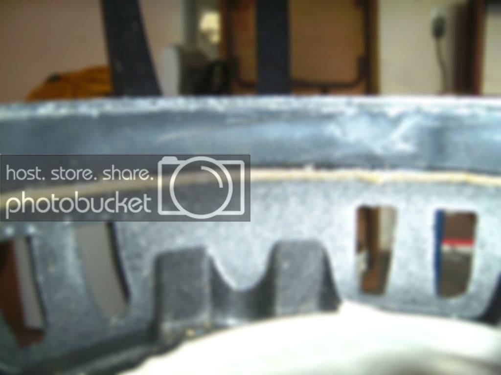

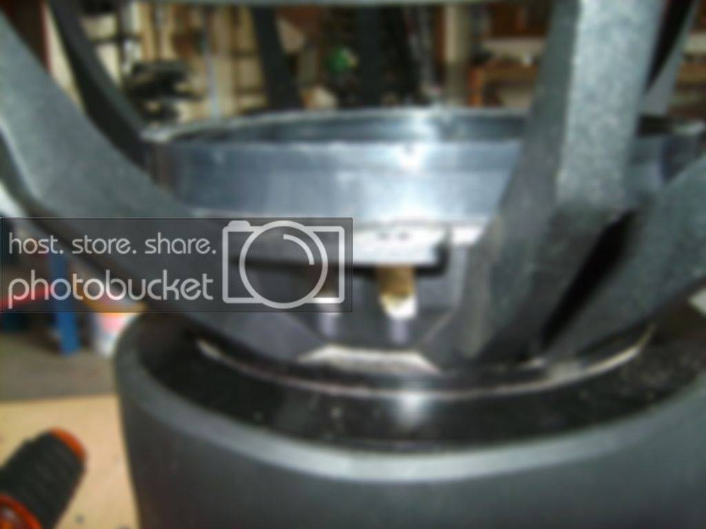

I'm cleaning my hdc3 up and getting it ready for a recone but i need some help.
I have it taken all apart and need help on getting the bottom set of spiders cut out.
The bottom set of spiders is yellow and it's like they're sandwiched in between the ring that's on top of the basket.
You can see them better here.
If you've reconed one before do you have to take that ring off or what.
I've been trying to get it off but that piece is plastic and i don't want to jack it all up.
Allright, i've been trying to get it off for a while now and wanted to make sure.
What do you mean by a new spider pack
The HDC3 uses multiple spiders.
This is referred to as a spider "pack". //content.invisioncic.com/y282845/emoticons/smile.gif.1ebc41e1811405b213edfc4622c41e27.gif
I know i already removed the screws.
Gonna try and finish it tomorrow. Thanks for the help guys
tell u one thing though, when reconing, you will not get thoughs screws back in //content.invisioncic.com/y282845/emoticons/fyi.gif.9f1f679348da7204ce960cfc74bca8e0.gif
my self i just used a **** ton of glue. works great. i dont have a problem
