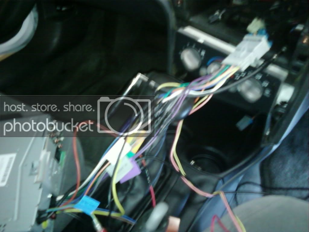

Ok, So I did my HU install today and when I finished ( I think ). It wouldnt even power up after I turned on the car power...
Here is what it looks like...

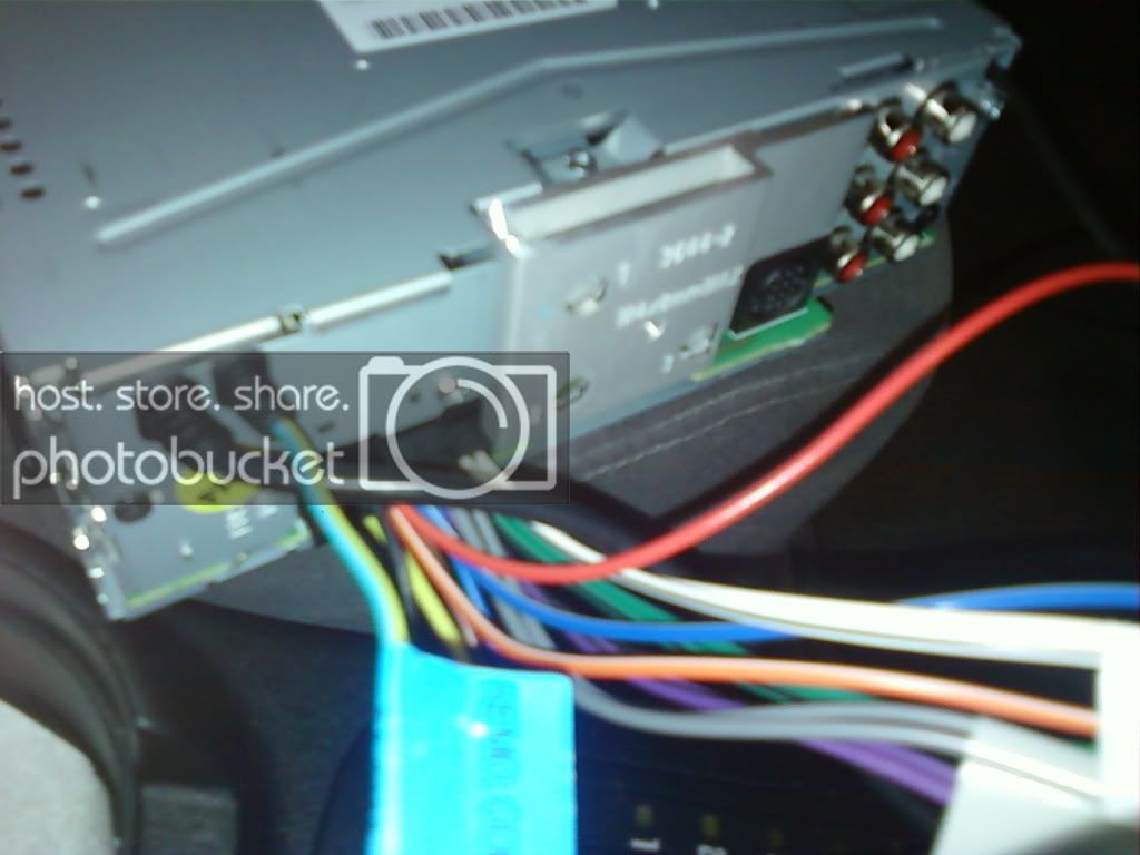

Back of New HU

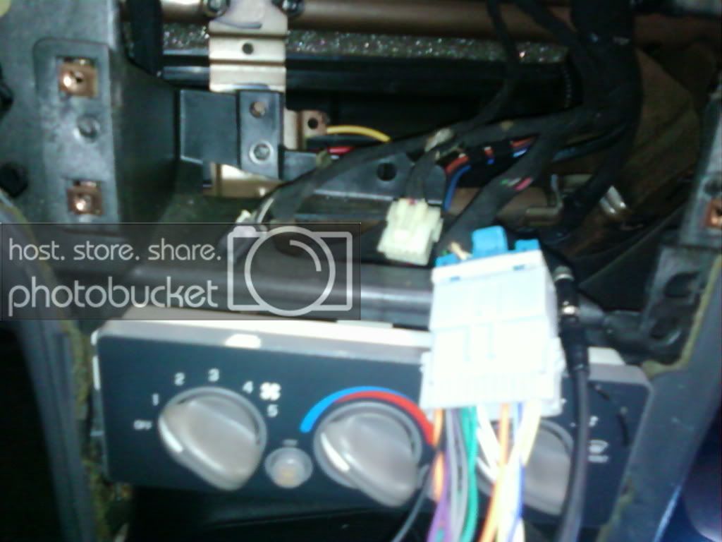

Inside Shelf...What are the two cords not in use??

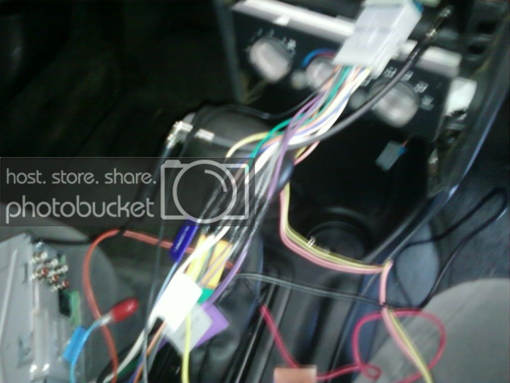

The wire connecting...All of them are connected to the right color.

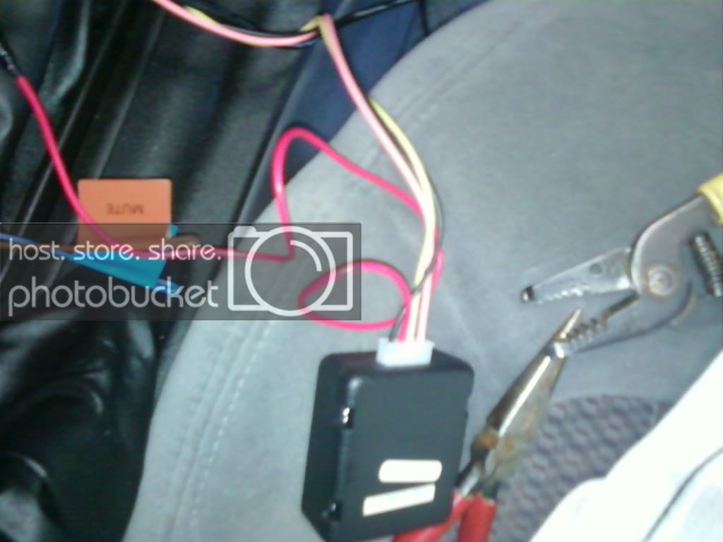

The Chime and Two Wires not connected...Mute and Antenna

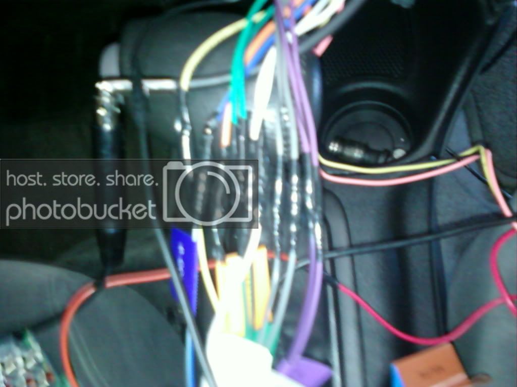

Mess of wires...Anything wrong?
Everything
So, What does it look like I did wrong?? I can't find anything. Some help would be very useful. And keep in mind this is my first car audio project ever
More then likely the red wire needs to be ran directly to a fuse that turns on when the car turns on. I had this porblem too. The power wire in the harness doesnt work for some cars. This was for my car (07 grandprix) and a 08 escape. Simply run wire from the fusebox that turns on when the car turns on. Then it should work fine.
orange does not need to be connected. and normally there is one under the hood and one on the inside. I know for my grand prix it was on the passanger side but you will have to find out. Should be in your owners manual. Look up which fuse does what and find one that starts when the car is started. Otherwise you will have to turn your radio on and off manually everytime..
