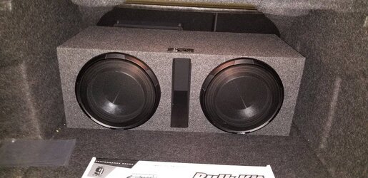

This is the one I'm considering. What's your thoughts? Its tuned to 35 hz
Either one it is I would turn it around and leave clearance for the port. As it sits now is not best in the pic imo. Letting the thing load off the hatch would be best not firing forward.

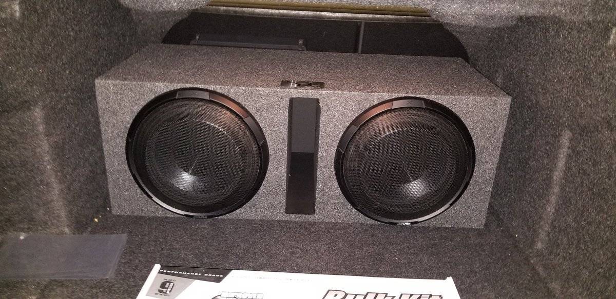

find the volume and port area/tuning and model it up on your power or planned power... idk... got a pic of the current box for comparison?

Yeah so this is the pic of the guy who I might buy it from. I would definitely have to place my subs in the box, not outward like he has them. Here is what I got now. What would you say now after seeing both?

I'd say straighten out your signal and electrical woes, try to get more power (2Kish or more), wire to 1 ohm this time and get a different enclosure built.
Something like this below ought to do the trick... at least that is what I'd do if I wanted to get low and louder
I really don't know what your goals are, you said "in your chest" iirc.. but something like that ^^^^ ought to be a REAL improvement over what you got pictured especially if you up the power some and clean-up your signal.

I would not get that box because its not the best configuration for your trunk and its a sh*t fit.  If you or any friend or relative has a screw gun and jig saw, i'd recommend building your own box. I'll get you a design and cut sheet. Buy wood at home depot or lowes, have them cut the wood. take it home, glue and screw, cut the sub hole and viola you are done. that rockford amp is fine for 250.  This wolfram 2400 amp is also fine for 250 new and its tested to do 2500 watts and its solid build quality.  Use the rest of the money to do a battery in the rear.
