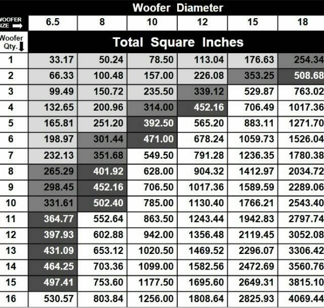

Only for reference, numbers aren't exact

yeah so 2 10's have more cone area than 4 6.5's and will play deeper, but again if boxes are small sealed it's not gonna blow up the town or anything anyway, and to loud is not a problem u can adjust power down
