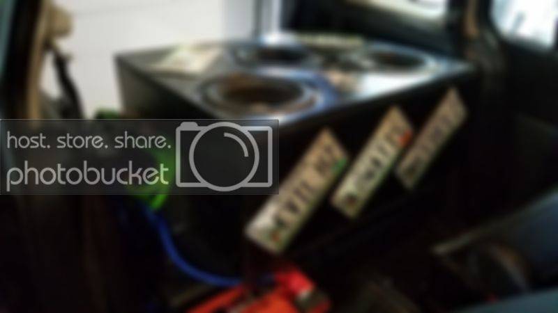

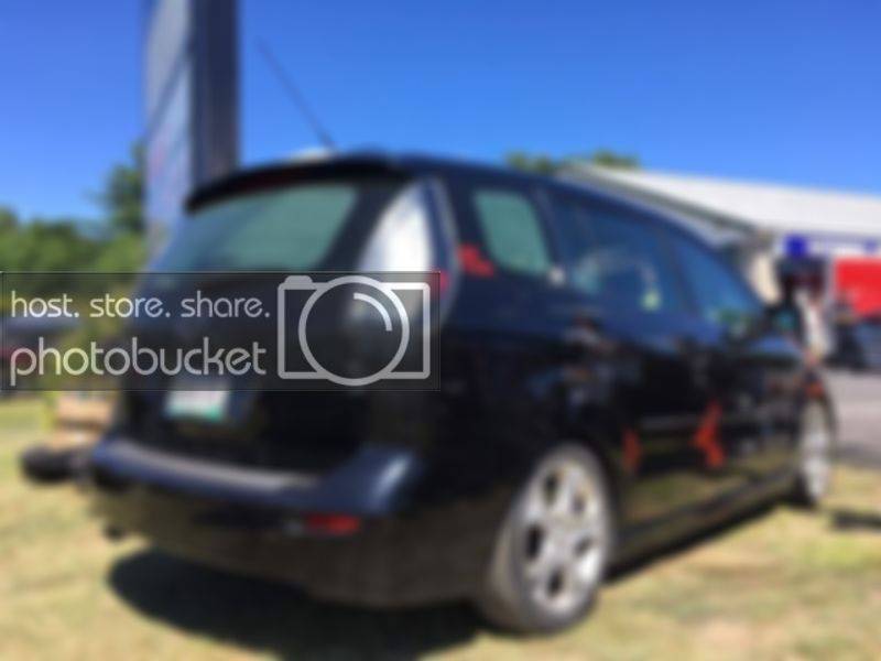

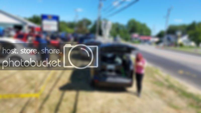

Had our biggest show of the year up here in northern New England and I brought out the family Mazda 5 mini van to shut some mouths up. Mission accomplished! I smoked a sub being stupid while testing last week, so I swapped to my backup and didn't even turn the amps on until it was time to compete, needless to say I went in fairly blind, except knowing roughly what frequency to burp at.
My equipment in the van consists of:
Three custom TC9 12's with Sundown and Shocker soft parts
Two Sundown NS1's burping @ .25 ohm each
Two 45ah JY Lithium & one Batcap 4000 battery
Three 6inch aeroport birch box
Roughly 44hz tuning, peaking about 48/49.
Threw the old vanity plates I had on my previous cars on the box for some neat looks...
Not too bad for a mild throw together install...
