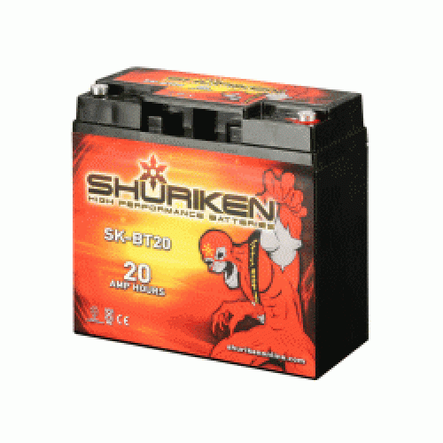

The second battery is a shuriken 20 amp battery. its ran with 4 gauge. Its wired as if it were a cap. The JL amp is wired to that battery. The whole setup is ran in 4 gauge. I have not done the big 3 yet. i was looking at the cables under the hood and they are either 4 or 6 gauge wire so i figured that would be efficient enough.
