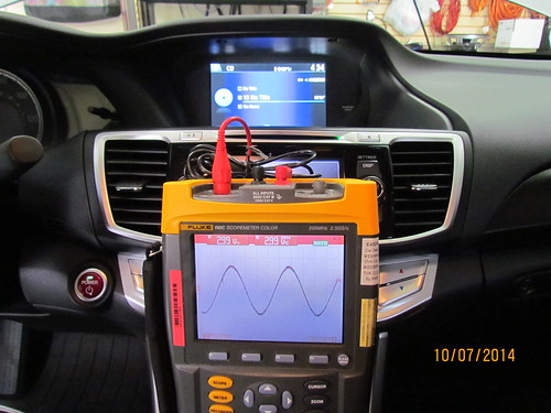

So i recently had a local shop upgrade the audio on my honda accord, the problem is the tweeters sound harsh (at least i assume its the tweeters) especially guitars on rock and metal. it's worse obviously as the volume increases. its been back to the shop twice so i think at this point i need a new perspective.
my current set up is:
Factory Radio (no eq) bypassing factory amp to a Wavetech 2ch line driver feedings a Kenwood XR901-5 5ch amp, front/rear ch's bridged to JL Audio C3 components on axis and a boxed sub in the trunk. Rear speakers disconnected. Tweeters are in the factory sail panel location.
The JL x-overs are already set down to -4db so I'm suspecting that its not a db level thats causing the issue. The speakers were checked and are in phase (not sure about acoustical phase). The shop has suggested a sound processor but i don't think i should have to buy more gear just to get this set up listenable at volume. Maybe it needs sound deadening or a new tweeter angle or position? Is possible the tweeter could use more attenuation and needs a resistor?
Not sure if this is any help but I did compare the spectrum with an app comparing the same song on my home receiver 2.0 with the car 2.1 sound:
Thanks in advance for any ideas!s

Hey Jeff that’s a great detailed response, thank you. However Im pretty sure the shop confirmed its a clean flat signal coming out of the head unit and all the x-overs and filtering is done at the factory amplifier - which was bypassed.
ok i had actually researched the signal from the head unit before booking it in at the shop, the shop just confirmed it. it could all be wrong i guess but i just want to rule out things in order to find the source of the problem. here is a quote from the honda audio forum that states the same thing:
"For the Premium audio system,
The factory HU is a high quality unit with a clean and flat output, no EQ is needed to correct it. The output is a balanced line so you need an amp with balanced inputs (JL, Kicker, Rockford ) and others have this feature.
The factory amp is an 8 channel unit with a dedicated BTL amp for each speaker. The factory amp is where all the crossovers and frequency shaping takes place. If you want to upgrade your sound you have to replace the factory amp first.

Hey Jeff, i agree with you that its quite possible its a phase issue or reflections issue but i want to start out knowing i have a clean flat signal leaving the head unit. here is another post with the same head unit as mine, he has a picture with scope on the output verifying it to be clean and flat:
i would have had no problem going with a DSP amp but was told i wouldn't need one and has been bought and paid for and wired as it is. I would really rather not have to waste all this money and throw more at it. i think i should be able to get reasonable sound at volume with the set up i have, as long as its diagnosed properly.

Notice how that install has an arc audio ps8 processor. Any real SQ install has to have a DSP.
FYI, Keep in mind, the measured signal can be flat but what actually matters is what your car is measuring through a real time analyzer when everything is installed. I highly doubt your car is anything even close to flat. Thats where the dsp comes in. You dont have to throw a lot of money to the DSP either. A dayton DSP 408 is 150 dollars and the bluetooth dongle is 30 bucks which allows you to tune on your phone and will give you everything you need to fix your current issues. All you need to do is plug the wavetech to the dsp. get two or three pairs of RCAs. to go to the amp. You'll want to take out the passive crossover of the JL C3s. Have the tweeters wired on channel 1 and 2, turn the high pass filter on to 1000 or so on the amp for protection. Then have the mids wired to channel 3 and 4. You'll want to play around with crossover points and slopes usually around 2500-5000hz range to get the perfect blend between mid and tweeter so you dont get that harsh guitar. You can even adjust the level of each mid and tweeter independently so right and left side will have the same output levels. Time correction will allow sound waves reaching your ears at the same time and you'll actually have a proper sound stage. Then EQ for fine tuning adjustments to build your ideal response curve.
You see what you are missing right now? Currently you have no control over the output levels of the right and left mid/tweeter or even between mid and tweeters. You have no control over the crossover point. Your left speaker is closer to you than the right so sound waves are not hitting your ears at the same time. Top it off you dont have fine tuning adjustments. All you get is your accord acoustics and how your Passive components arent agreeing with those acoustics.
This whole thing should cost less than 250 bucks after tax accounting the dsp, RCAs, and speaker wire/install gear.
