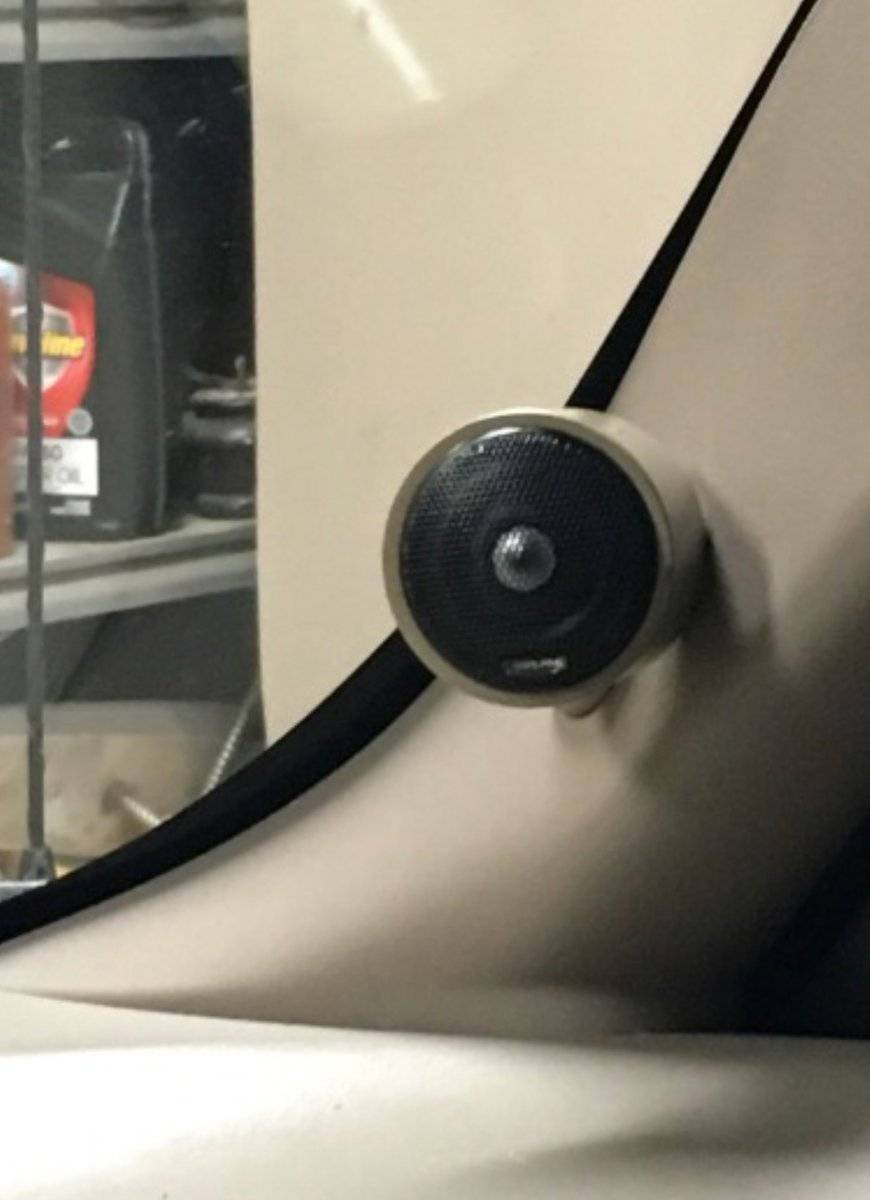

These have my attention. Did they come with mounting hardware?how do you have them crossed over and at what frequency?
No mounting hardware. I have mine siliconed in some 1 1/2” conduit pvc caps that I painted and mounted on the pillars. Like mentioned before, on axis is working  for me crossed at 2700. They sound really nice with my silver flutes.

Looks good. I ordered a set to go with the silver flutes I already ordered. What amp do you have powering them?
Kenwood excelon 900.5. I’m about to put more power on the silver flutes. They sound great but I want to see if I can get a little more out of them. I think they really need about 100 Watts or so to really perform.
