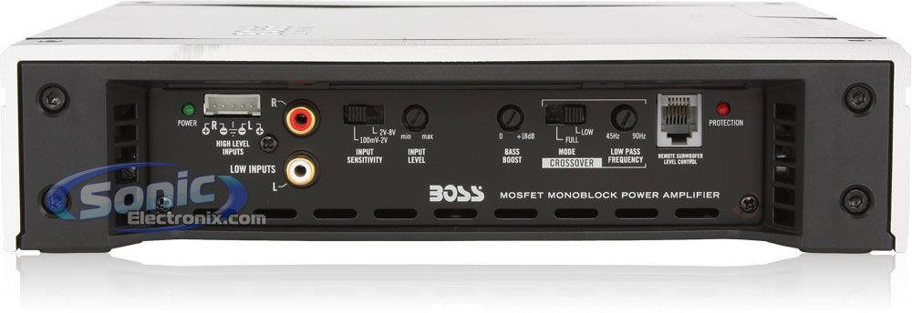

I have been using a borrowed Kicker KX400.1 amplifier on my 10" Audiobahn 1000N fully sealed subwoofer and it sounds amazing so I finally got enough to get my own amplifier and got a Boss PH1500M Phantom and it sounds like garbage comparatively. I'm not getting the same level of power or range in frequencies that I used to by a large margin.
Is the new amplifier just not as good? Or is there a break-in period for this amp? Or am I just setting the levels on it wrong? I'm relatively new to the DIY car audio field and would love some feedback. Thanks

what HU are you using? is it compatable with where you have the gain switch set? Is the x-over set to LOW and turned up to @ 90hz?

before you return it, tell us where you have all of the settings at (reference pic above).
These guys said it. You get what you pay for is typically a good motion to follow in the CA industry. Kicker amps (even the cheap ones) are good quality amps that put out rated or above, and do so with a great clean signal. Most cheap "MAX WATTS" output amps aren't going to put out anywhere close to what's claimed on the box or sound as good as a quality brand amp.
If you could measure the actual power of those two amps you'd find the Boss to be about 1/2 the kicker.
More than all the other factors combined - that's what you're hearing.
A significant drop in actual power.
Pre-purchase it would have been pointed out to you that kicker makes solid amps that tend to be more powerful than specified.
Boss notoriously grossly over-rates their equipment because there's no governing body that will hold them to their claims. Regardless of its rating the 25A fuse tells you it's no better than ~250w.
Power output is not nearly as important as 99% of the people here seem to think. Whether or not it does rated is pretty much irrelevant. Even if it's rated at 1200 and it does 1000, that 200 watts won't even improve SPL by 0.5 db. That said, the Boss amp probably outputs 200w @ 2 ohm verses the Kicker amp doing 400w (still only a 3db difference).
Regardless of power output, it sounds like you have different crossover settings that you don't like. Play around with the crossover settings before deeming everything garbage.
