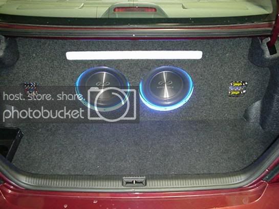

not sure what to call it, i consider a "wall" for aesthetics. this . . .
i plan on using a piece of black Corian. question is how to secure it. do you fasten it to the box or fasten it to some part of the trunk?

that wont sound worth a ****. How do you expect sound to get into the cabin if the subs are sealed off facing the trunk? Your best bet would be to chop the rear deck up and to fire the subs and port up through that, sealed towards the cabin.
does make sense. i just figured the port was in the back towards the seat.
i had planned on porting through the rear seat. there is an opening back there, i guess for "skies" or something
