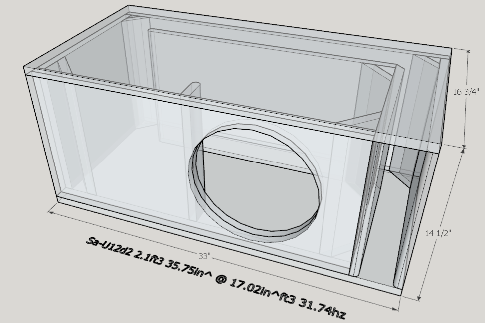

To spec?... something along these lines will be closer to what you need for that amp/sub...
That's a lot closer to spec than that prefab... and should do a lot better.... personally I'd tune a little higher but it was not my call... lol

U12 in a prefab?.. That one above has 21^ of port and is probably 1.8ft3 net ad at best... so it is truly bad with a 30mm x-max driver on 2K... output limiting for sure.
