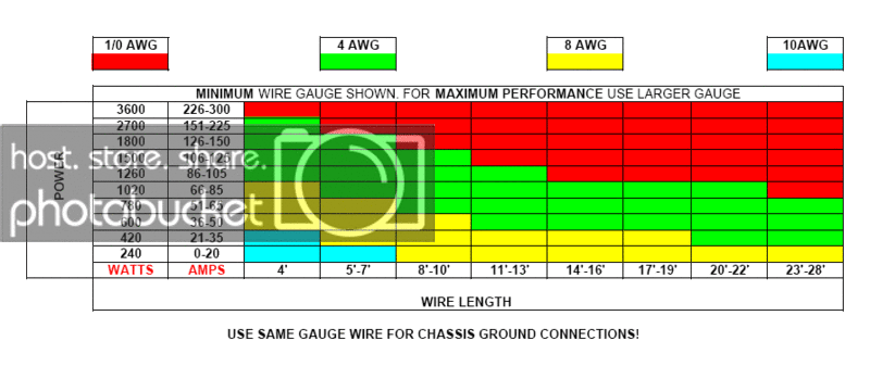

and is 40 the max fuse to use for an 8gauge wire?
No its like 50-55

ok, putting a bigger fuse in ur power wire is not going to "super charge" ur system //content.invisioncic.com/y282845/emoticons/rolleyes.gif.c1fef805e9d1464d377451cd5bc18bfb.gif
if you want it to be louder you are going to need to upgrade the amp and the power wire..
rule of thumb:
fuse accordingly to how many and what size fuses are on the amp....
