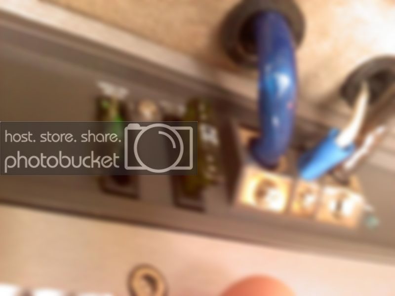

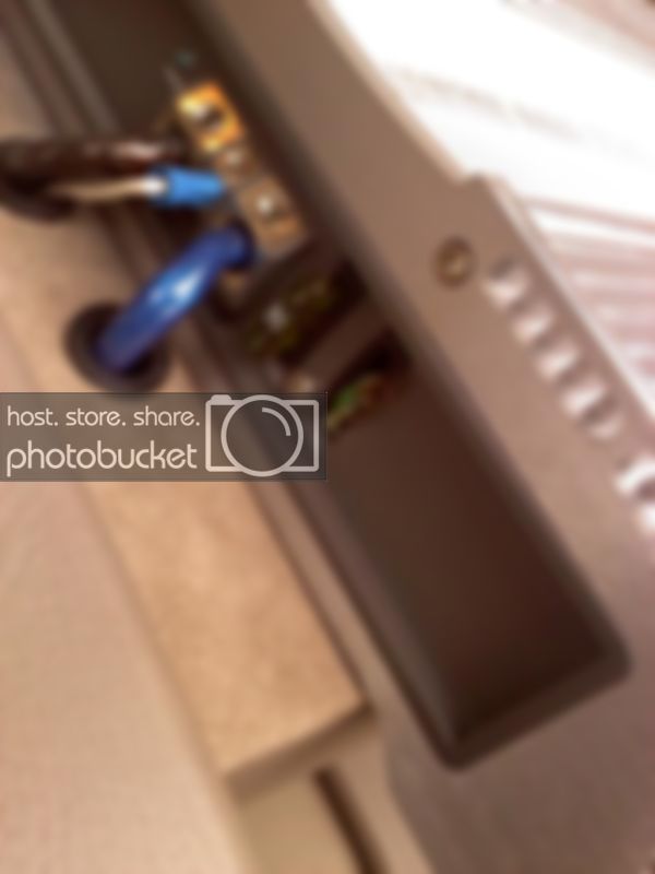

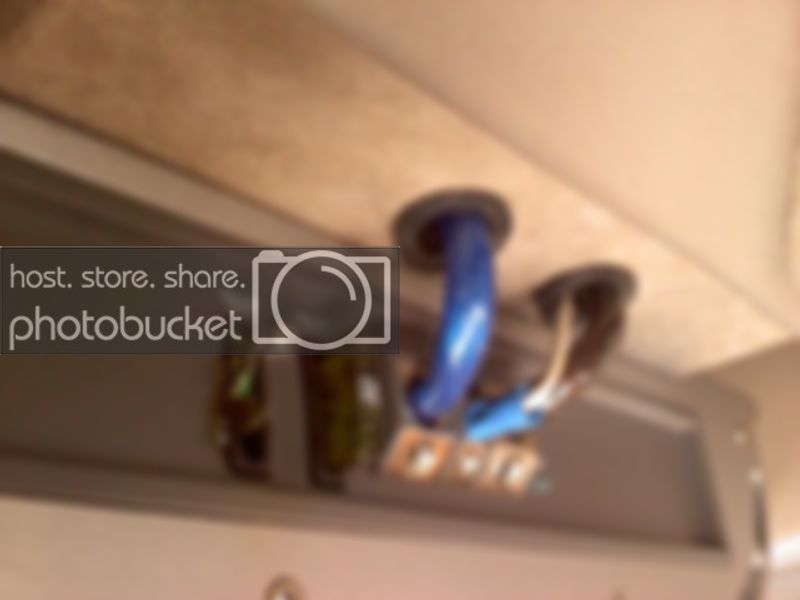

Sorry if this is in the wrong section. I just signed up in hopes for someone to help me out. I have a Diamond 300.4 and one of my fuses has actually melted into the amp. What can i do to remedy this? Will it hurt the amp if i get it out of there or should i leave it? it works fine still but looks like crap.

Here are some pics (sorry for quality)

yea! then idk what to tell you send me some pics of the fuse sid so i can see what to do.
i think this happend when my main fuse under the hood melted. i have a couple fans back there but i dont think it was just heat alone. i was probaly getting low voltage or something.
so i can just take that side plate out and clean it all out. is it a pretty straight forward thing or can i risk screwing it up?

You might need to have that fuse holder replaced.
They're plastic, and if a plastic fuse melted in it, theres a good chance that holder is also melted.
