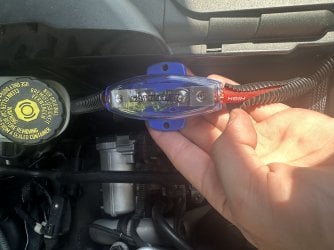

Anl is common for larger wire. There are a lot of different types of fuses.
Hold the fuse in your hand and google audio fuses. You’ll find it or maybe decide to get the right one if the one you have isn’t ideal for your setup. Chances are you’ll want to go up in amperage if the other one blew. Disconnect your battery too whilst you’re working on the electrical stuff.

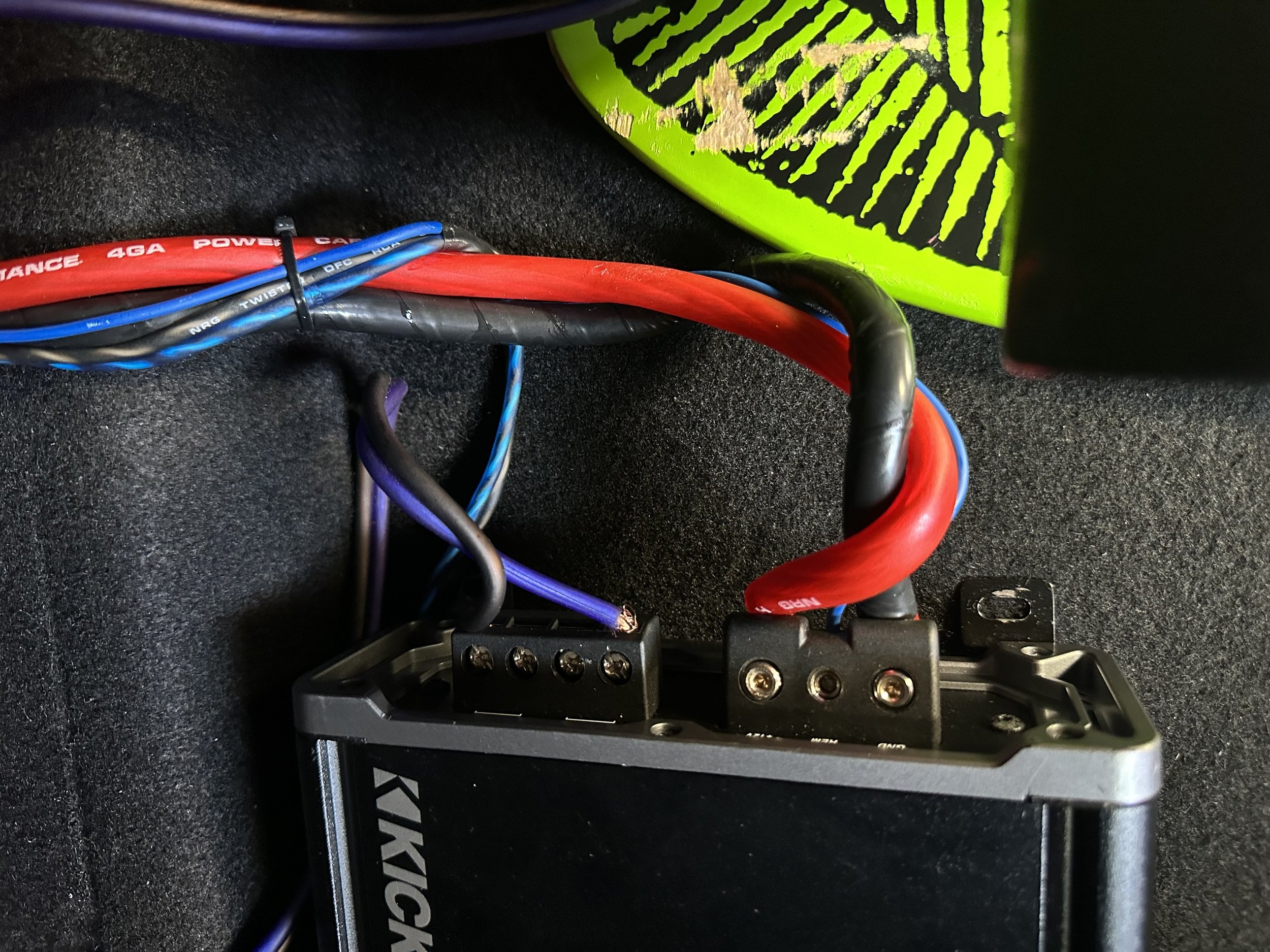

You really need to know the gauge of the wire. If you fuse for 0 gauge and it's really 4 awg, you risk a serious wire fire. Also dose the amp have it's own fuse?

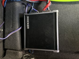

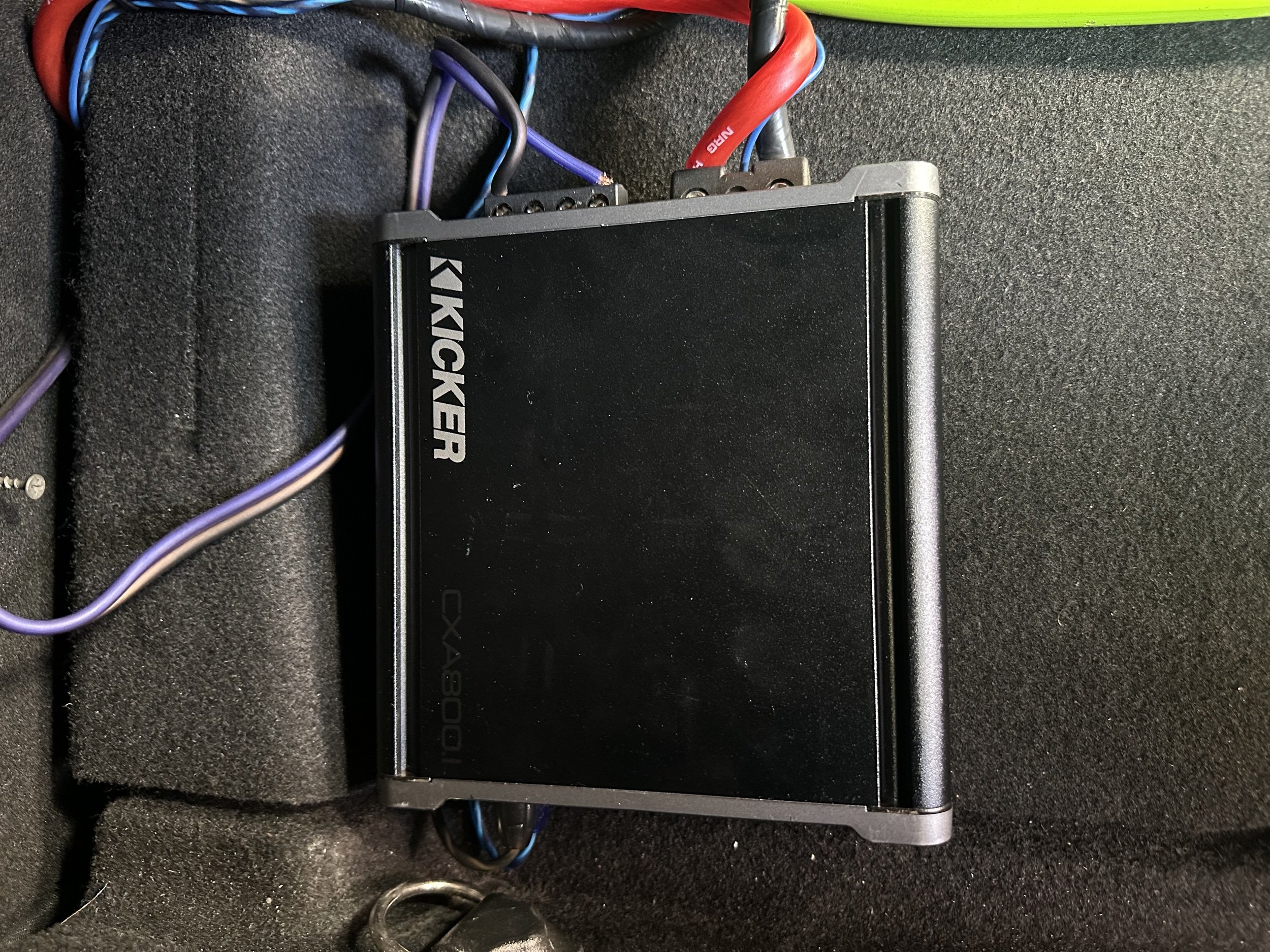

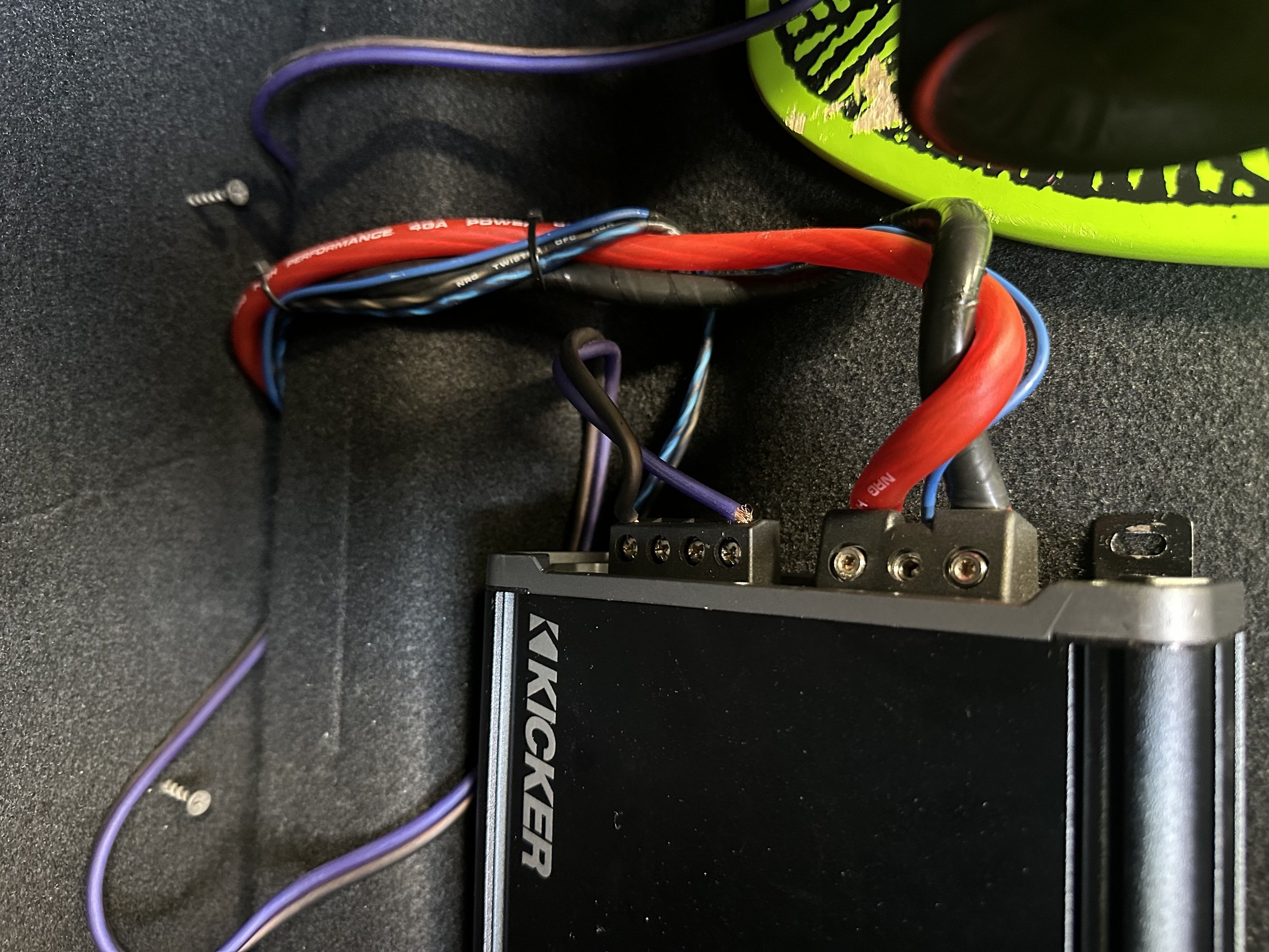

Hard to Guess.A pic of the wiring 2 the battery and @ the amplifier connection will help.
I should have posted them to begin with. I uploaded them, so that amp in the pic is my old one. I want to install this amp here
but need to know which fuse size to use and if I need to replace the wiring or not.

The amp requires a 180amp outboard fuse. You need 0awg with a 180 amp fuse at the battery. If you fuse 4awg at 180amps you risk a wire fire as the fuse will pass more current than the wire can handle.

That red wire says 4ga on it. 4gauge / 4awg. That is too small for that new amp.
For the CT amp, you need to replace the power and ground wire with 1/0 OFC cables, and you can fuse near the battery at 180 amps. If the power cable is less than 15 feet, you could also use a 200amp fuse near the battery if that is your only option, (180 is better though). (If it's longer than 15ft you might be able to go higher, but we would be getting into a gray area where we would need more info).
