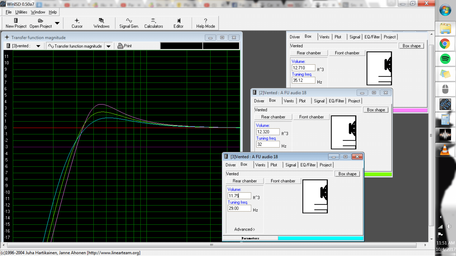

The tuning will be your preference. 35hz+ will work better with rock and normal music etc... 32 will work with deep hip hop songs and re-bassed music like decaf etc.. 29hz will be mainly rebassed music. this graph shows what the frequency response will be like.

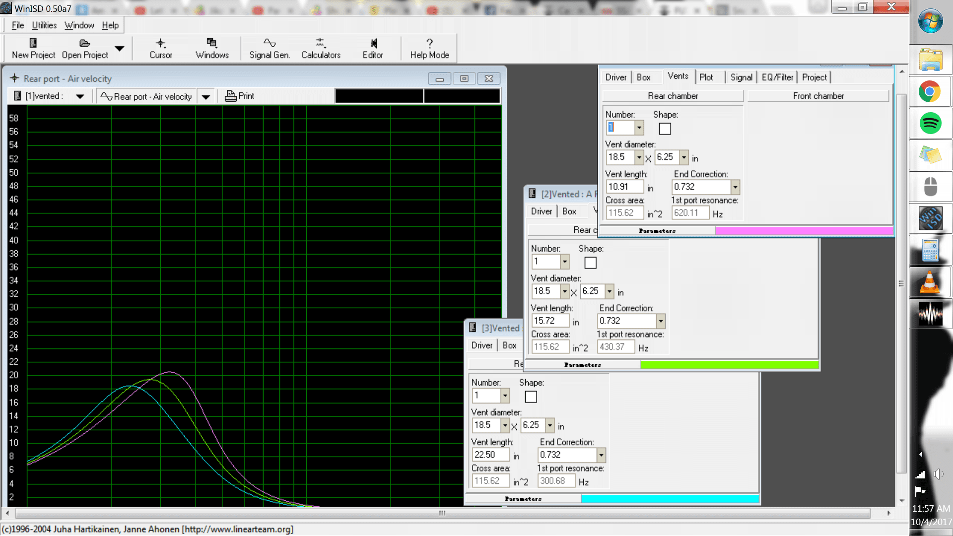

With those port areas on 1500 clamped rms, you wont see any port noise.

Looking at the graphs you post looked like u we're using my numbers, so does that mean the the design for the 32hrz I posted is ok? And I planned to double baffle and use a few 1 1/2" dows to stiffen up the box with cross bracing and angling them all to make the air flow smooth. Also planned on priming the entire inside and using a bed liner spray on the outside. Would it be ok to do .75" + .50" + .75" for the baffle, using a 1/2" mfd piece to triple it up instead of 3x .75" or but if when I lay my pattern out if I can't get it done with the double baffle in 2 sheets I'll buy a 3rd and just do it that way. I'm picking up a Craftsman table saw and the wood tomorrow, already got pounds of 1 5/8" and 2 1/2" deck screws, a huge bottle of Titebond III, a new drill bit set, a few tubes of silicone, a bunch of spiked T-Nuts and hex head bolts(only 1 1/2" cuz I planned for double .75 baffle) but I can change em out I got my reciepts. I found a nice looking plunge route table I'm trying to get too but idk if it's still available.
