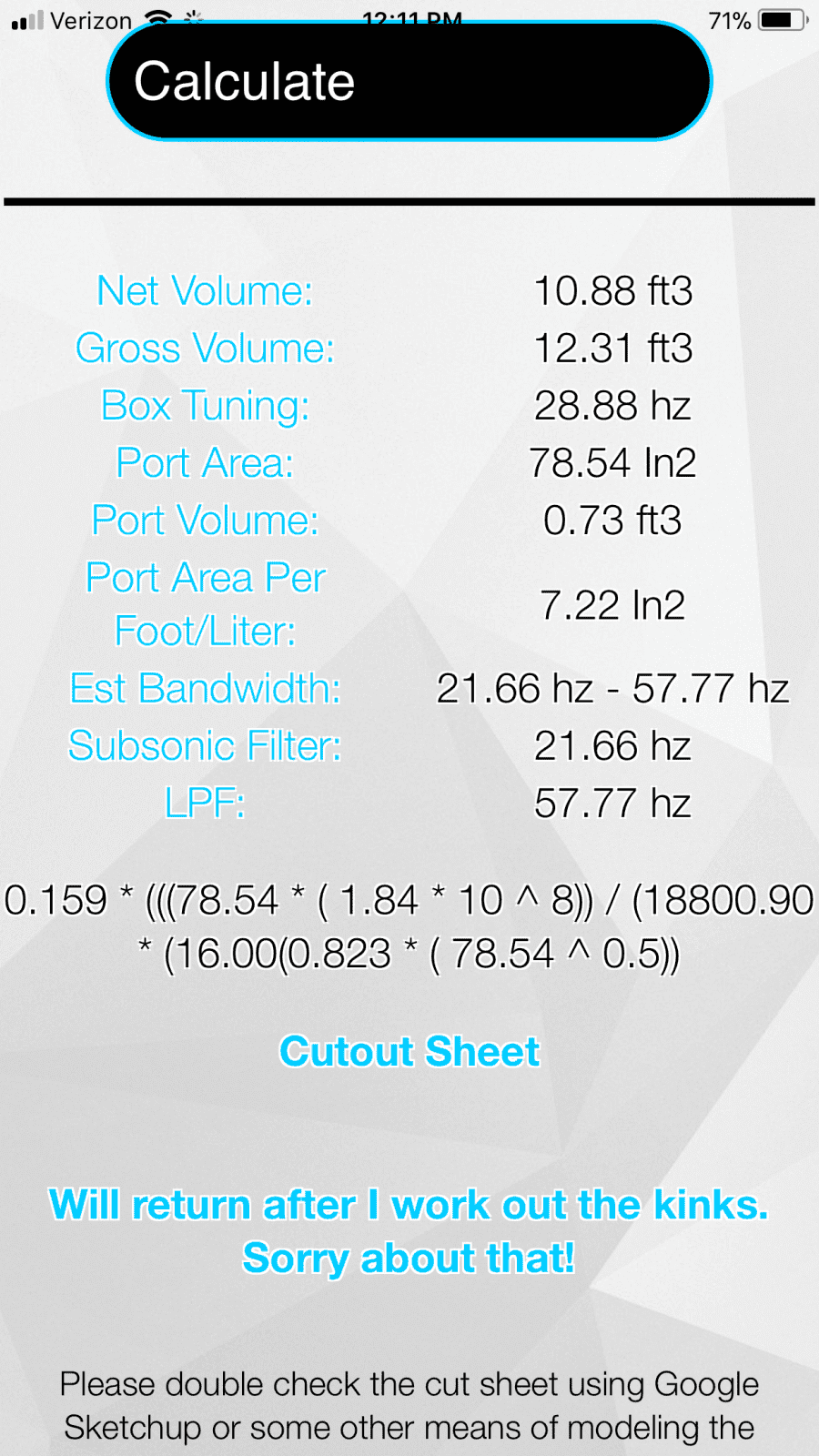

Instead of their specs experience plays a huge roll. I just grabbed two 1250 15s and here's box I'll be using. I was iffy on anything but sundown but triple stack motor 25mm xmax and fs of 29 and the price I got them for I couldn't say no. For 18s like hertz said 7-9 all day. This is what a real box app does and helps
