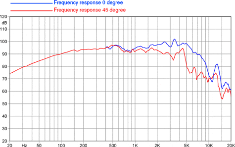

btw look at this pic. it says 0 degrees and 45 degrees. 0 degrees means facing the speaker directly? and 45 degrees is when the listener is standing off-axis at 45 degrees to the speaker? just trying to understand what this stuff means.

beaming is when the dispersion pattern is narrow from the wave length of the sound. most times if your have your mid-range drivers 30-75 degrees off axis even with a 8" driver you can cross it around 2500.
Id be more concerned with comb filtering, phase distortion, refraction and using the proper placement and air space for said drivers..

beaming is when the dispersion pattern is narrow from the wave length of the sound. most times if your have your mid-range drivers 30-75 degrees off axis even with a 8" driver you can cross it around 2500.Id be more concerned with comb filtering, phase distortion, refraction and using the proper placement and air space for said drivers..
1k not 2500. If it was 2500 way more would be using them with tweeters instead of widebanfers.
