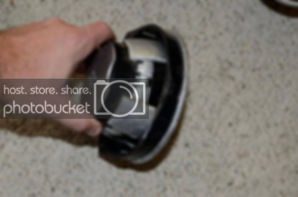

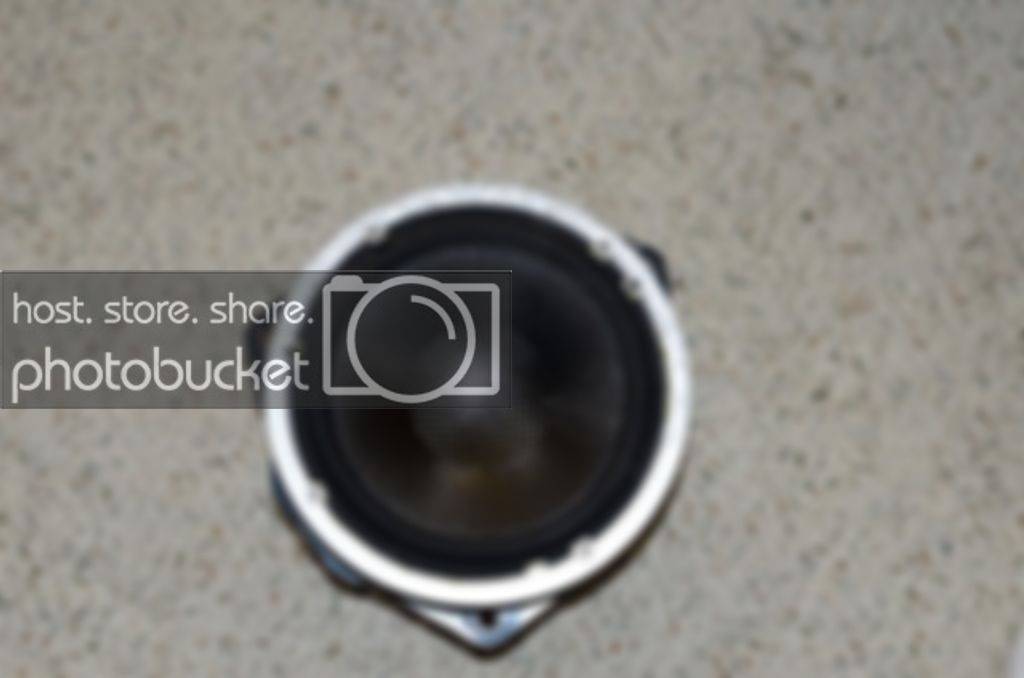

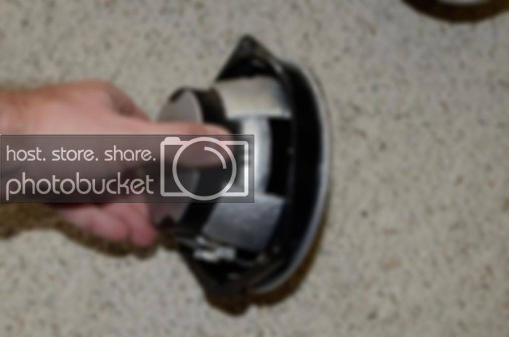

I checked the voice coils on all of the speakers and they all show 3.0-3.2ohms. All of the speakers move freely, with no binding or "scratching". I checked the 4 channel RCAs (KnuKonceptz) for continuity, and they checked OK. The only thing I did find is that the MOMO woofers that were mounted low in the front doors had some corrosion. The driver's side was pretty coroded, and the passenger side was just starting to corode. Is there any way for me to test any of this stuff out of the car? Would the corrosion in the woofer cause these issues?
