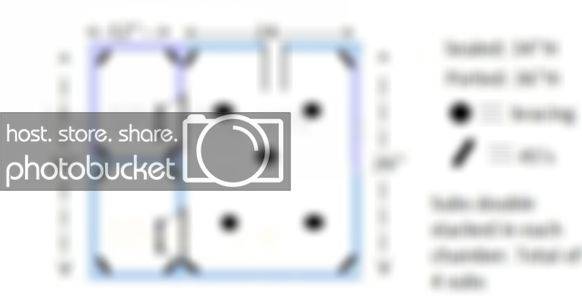

Have a design Ive been working on.. This is my first attempt. Using Bassbox pro 6 to design this beast, but I have stumbled up on isobaric design and wanted the opinion of people who tend to experiment and run these types of set ups.. Please any and all help is appreciated..
First, my design
Now, the isobaric design that I find interesting...
Which one has the most potential to get loudest?? Is there anything Im missing here?? ALSO!! Im lost as to how I am suppose to build a top that is "removable".. how does one do that?

my little 4th order box i did for my dd 1508 is .40 sealed and 1.25 ported at 44 hertz ,hits very nice and hits the lows well.so that a 1 to 3 ratio. also use weather stripping and screws to seal the top baffle of the box so it can be removed if needed.

the point of isobaric is not to be as loud as possible - so that should answer your question.
design the enclosure so you can experiment with port orientation - you won't know what is the loudest until you build and test.
removable top? not the whole thing - just a piece that covers the sealed chamber so you can remove woofers. the piece over the larger area needs to be secured/glued to the bracing - something screws wont work well for more than once. for this, make a trim lip that has t-nuts in it (two layers can sandwich the t-nuts so they can't come out).
it would be even easier to not to the top at all and just the side that the magnets face - making install/removal easier.
