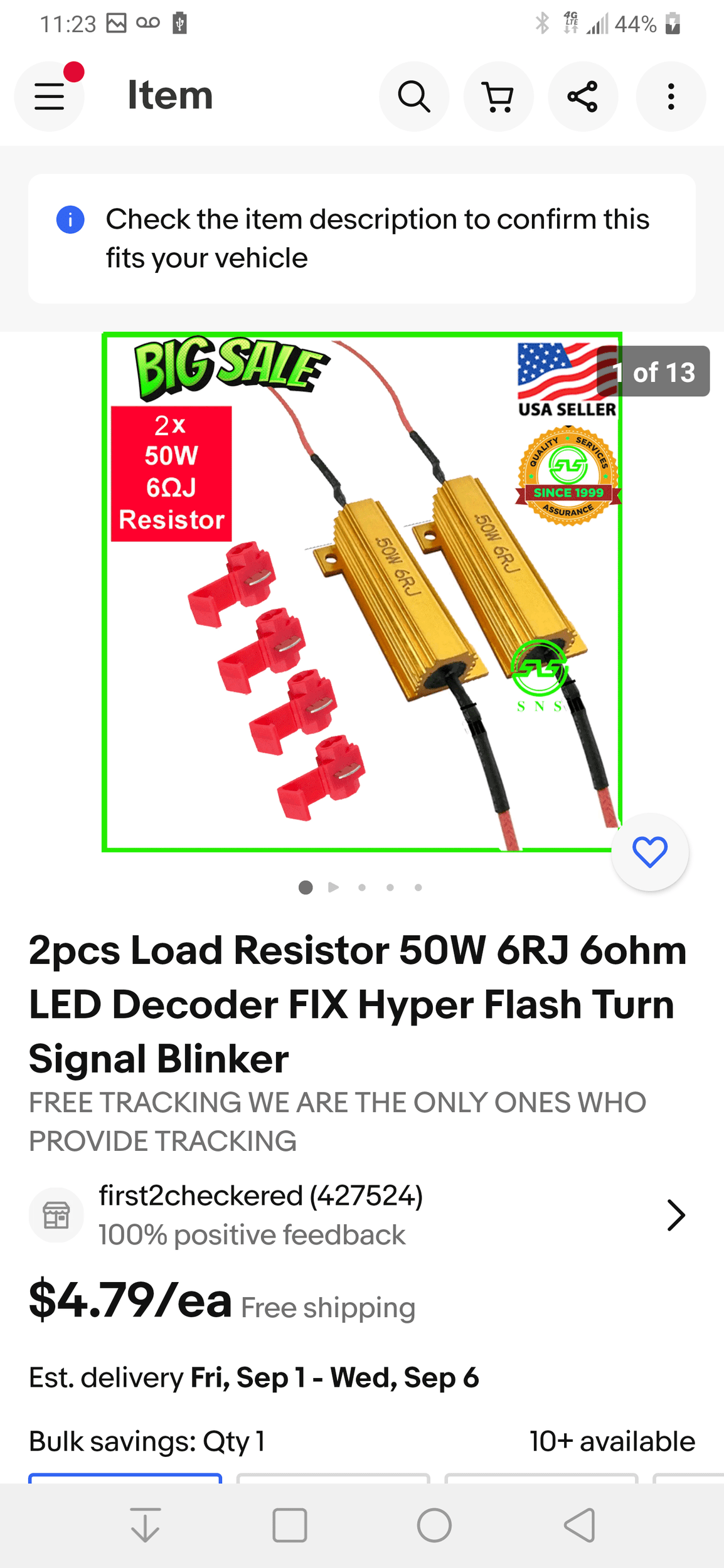

My nephew had those JLs with that JL 500/1. It sounded really clean to me but he wanted more. The Kenwood says 4 channel but a mono will work just fine. Like Marve_Lous stated, you will need an LOC to convert the sugnal to RCA level. You may also need load resistors if the OEM radio has resistance check.
We used a Digital Designs LC2 and 6 Ohm load resistors.

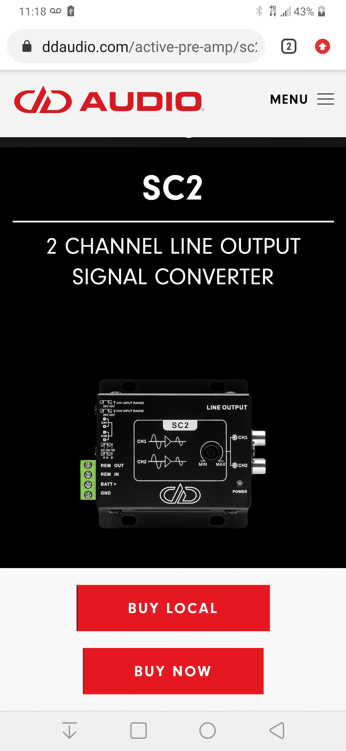

I don’t see an LOC. How are you getting the audio signal to the amps?
Sorry I overlooked that part. Looks like plugnplay had a nice LOC.

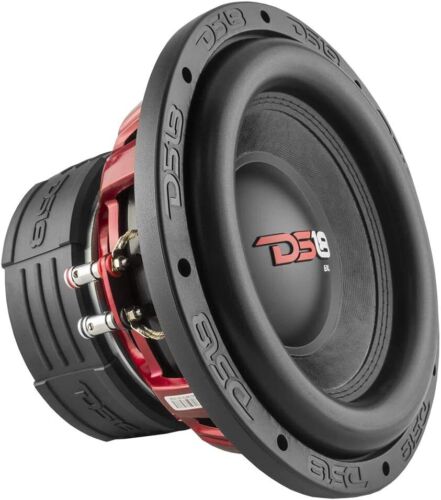

Thank you for the detailed reply! I love this community already. Those Sub look like they can get rowdy! Unfortunately I think their depth is too large for that box. Looks like 6.25" from the box vs 7.48" from the DS18 EXL-X10.2D.

Honestly in that box...I'd wager the jl's sound better...
Might, more of a trade off either way. JL designed for Sealed envirnment in a ported box as apposed to a box that is slightly small for the DS18. Pretty sure with the Taramps and those DS18's, it would be pretty good too. Not often a fan of the DS18 drivers, this one is pretty nice. I like JL, just think there are other very good options at that price point.
I disagree. From the DS18 site:
Ported Internal Volume, 21.23L / 0.75ft3. Assuming the port and the driver take up around 25%, it's a good fit! Even if not that much, it's well within a 10% tolerance either way. I modeled it in BASS Box Pro, it's got a 3db rise from the low end (around 34Hz) to about 50Hz, then tapers off fine all the way to 150Hz. I was offering it as an option to a driver (the JL) that is better suited for a sealed cabinet that could still handle the power of the Taramps amplifier. Other amplifier/woofer combinations likely work well too. Was trying to stay in line with the OP's pricing and still give most bang for buck options. The tuning frequency of that box is 36Hz. This DS18 sub should most definitely work well in this setup
