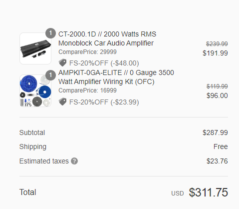

I am changing it up a bit. I've come across a superior enclosure from Fox Acoustics that can accommodate speakers with a depth of up to 6.25 inches. I heard the box was designed to accommodate two Alpine R2-W10D4 subwoofers but I haven't done any research on them yet. All powered by the CT-2000.1D amplifier. Yall swayed me towards CT Sounds, It looks like they have some good stuff and they are have a flash sale right now! 🥳
The 0ga OFC amp kit is on Sale also for just under $100 bucks! I can Vouch for that 2k. Mine gets down. Id recommend the 150.4 if you need a 4 ch as well. No issues with either amplifier
So if the CT-2000.1D is beefy enough to drive 2 of those Alpine R2-W10D4 what's the point of getting the 0 gauge cable over the 4 gauge? The 4 gauge is rated for 2,000 Watts and matches the peak for that amp. Thanks again =)
Because power wire failure isn't pretty or something you really wanna experience 😂
And the carrying capacity of wire isn't measured in watts...it's measured in amps...

Sweet! I just purchased the Wiring kit and the Amp! Do I need to swap out the main fuse for the wiring kit? The wiring kit comes with a 300 amp fuse and the amp recommends using a 200A fuse. Also I notice there were no external fuses on this amp like there are on others. Does this mean it has internal fuses? I'm waiting to purchase the subs and box for labor day weekend. Thanks a ton!
One fuse (the 300) goes close to the battery to protect the power wire...then close to the amp you'll add another fuse (whatever size the manufacturer suggests) to protect the amp itself
