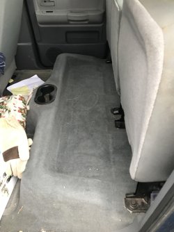

I tried that but he just won't put out the money needed to do it right. So going to use the CCA since it will just be that 100x4 and later on down the road the 800-1000 watt mono-block for the RF P3D210 that I have sitting here. That damn dodge dakota does not make it easy to put a subwoofer in anywhere. 4 door version of it and even with a seat lift on it still wouldn't be able to get a subwoofer box under it as it looks like this. Only thing I can think of doing is a ported truck box behind the seat. It lifts up for a small amount of storage and that is it.

I get it man, like pulling teeth! You can lead a horse to water... For that rear, same rig, new a guy where I used to work, yanked the seat, put in junkyard buckets, built a 6x18x20 (.75" MDF) box, mounted Pioneer TS-A3000LS4 Shallow-mount 12" 4-ohm subwoofer on one side an a 15" paassive radiator on the other side, stuck it lengthwise right in the middle, mounted to the floor and hit it with a GM-d9601 amp and i'll tell ya, it slammed pretty darn good!

Looks like you could raise the back seat maybe 2 to 2-1/2" use longer seat bolts and washers and frame/mold in the under carriage cavity of that seat and do a pair of shallow to 5- 5.25 10s and Aroe the port just on the upper side of the carpeting. may even look at another truck in the yard and see what type of cavity/room there is under that floor cavity to work with? But that CCA 1/0 Sky High will be fine for the 4 ch run and even a 1k substage. You can always make another run of OFC later on if need be.
