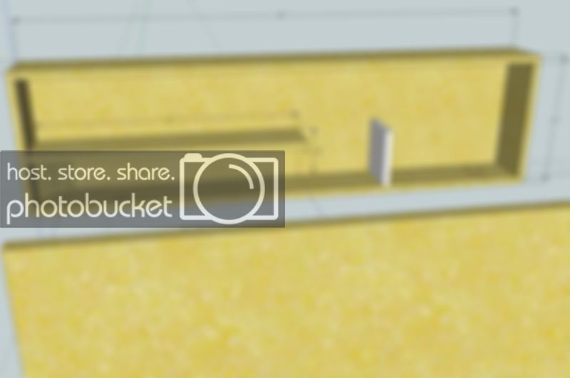

Here's what I got.
56x15x7
2.35ft^3
-.53ft^3 for port
-.12 for sub(just guessing, and for simplicity)
1.7ft^3 net.
1.7ft^3 with a 5.5"x5" port 29" long gives you roughly a 35hz tuning.

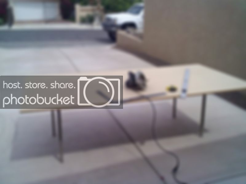

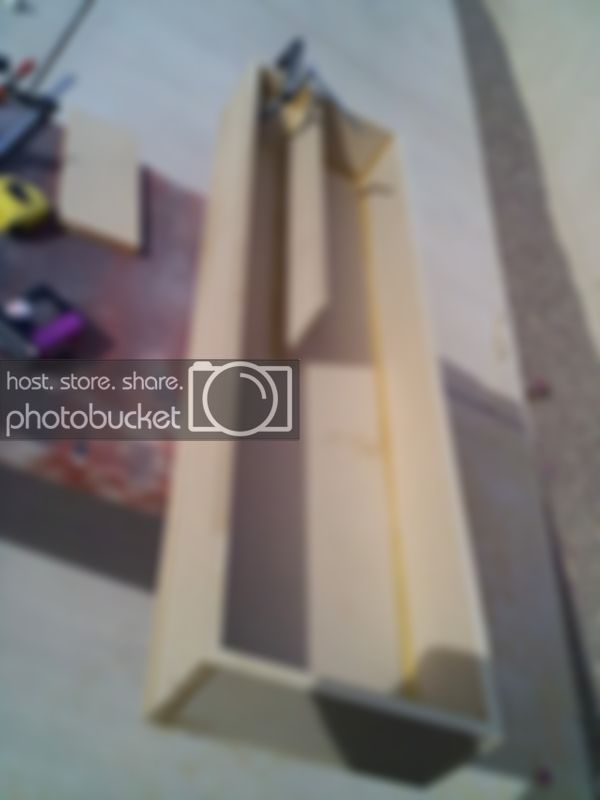

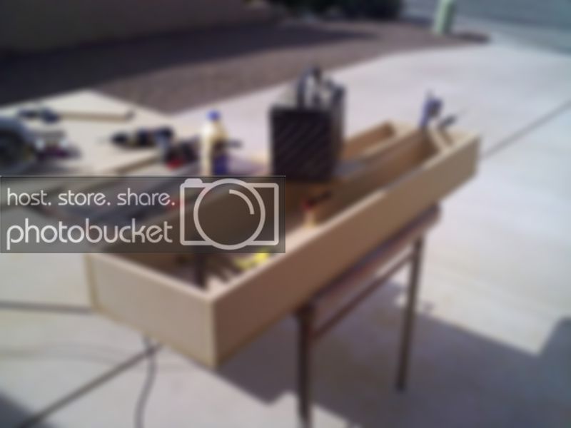

Here is the beginning, I got most of the work done but I realized my jigsaw was at work!!

As for the screws, you just pre-drill them with a 1/8" bit and they work great!

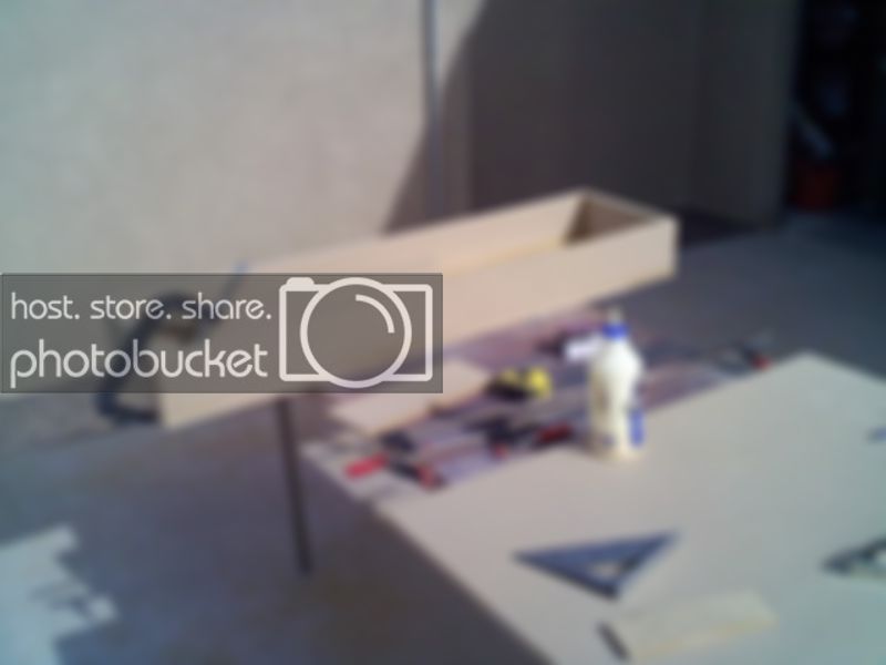

OK I was trying to keep the dead space from doing something weird.. Do you know of any adhesive I could use for the front baffle that will still come off later so I can just make a new baffle when I get the 8's??
I've used silicon in a situation like that. Creates a good seal and you can use a knife to cut it loose once you get the new subs. Just be sure to use enough screws so that everything is tight since you don't have the strong adhesive properties with silicon.
