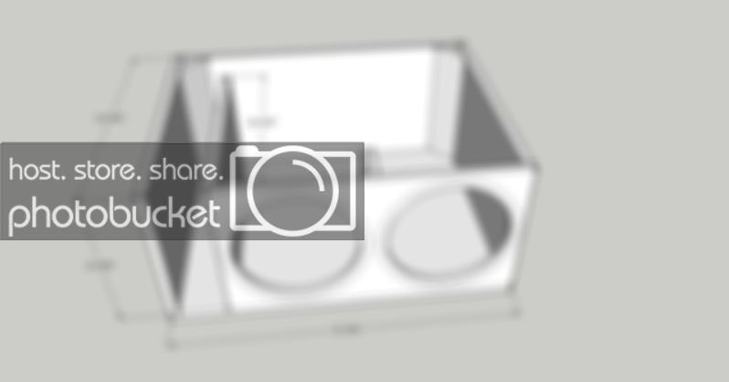

This box should get the job done for you. Its 4.25cuft tuned to ~35hz w/ ~14sq per-cuft port area...it will be fine w/ those DD512's.
External measurements are 31.5 x 15 x 24. Port is 4.5w x 13.5t and actual length is 24". Make sure you put a brace between the subs, a 3.5-4" brace will do. Wedges in the back corners will help also.

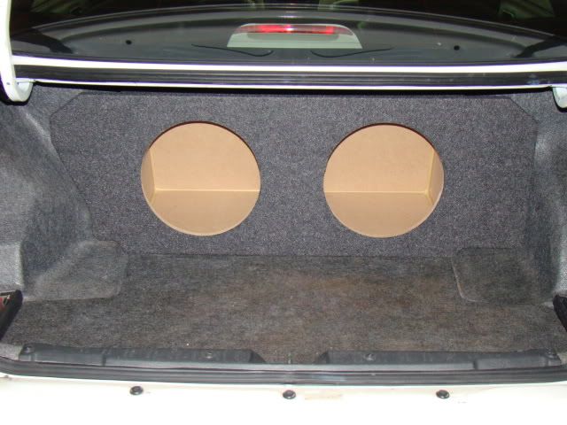

that looks good but i want to do a dual port b/c im going to flush mount the subs with a face board to cover all the amps, wiring ect. something like this
but ill cut out the area for the ports or would areos be better for this setup
so should i just do (2) ports 2.25w and 12" long
