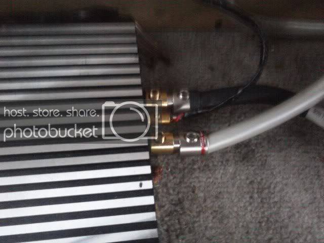

Like so:
Cause cutting the wire keeps the current capacity. Going to 4 ga. reduces it and reducers are just more resistance. Cutting 1/0 to 4 and heat shrinking it flipping the cut part down looks fine.
The 1800's wire goes in at an angle from the bottom it isn't a straight shot in from the side and that would look FarKed up on that amp.
I previously had my 1/0 in a 4ga terminal. Just cut it a little and didn't have any problems. Plus it was free and only took about 30 seconds to do.
