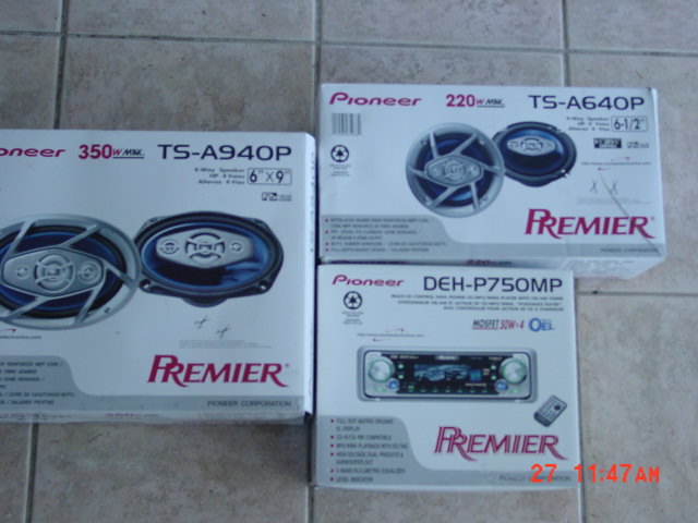

It took me 12 hours from start to finish. I had to figure out how to take out my back seats to remove the panels. It wasnt hard but there were screw that you couldnt see and would make you wonder why the panel isnt coming out.
For those of you that dont know, the rear 6 x 9s in the stealth have ports and the magnet was hitting the port so i had to use my dremel and chop a bit off. I also had to make custom door bracket for my 6.5s because the stock front speakers ar 6.75. I made them out of plastic sheet that i found laying outside. Works well.
The head unit was a fairly easy install except for the fact that the dash kit that i got (scoche(sp?)) sucks and doesnt fit flush and looks really crappy.
All in all i really like the look of the HU and its got lots of features. The speakers sound great and provide good bass. Im loving the remote control too.
Hey, has fedex teamed up with Rider. My box got delivered in a big yellow truck and i got confused until the guy handed my a big box.
Here is what my sytem consist of

Thanks...how can I tell if i have the new 6v HU. It was advertised on ebay as the new 6v unit.
And for all you nosey people i paid 314 shipped for the package brand new.
no rms in the chart at the end of the english segment? i guess that's your answer: it's the NEW 6.5V MODEL! you lucky bastard!//content.invisioncic.com/y282845/emoticons/smile.gif.1ebc41e1811405b213edfc4622c41e27.gif
the output voltage affects the gain(input sensitivity) setting on the amp. you adjust the amp to match/compensate for your ouput voltage on the H/U.
Alright so the gain wouldnt have to be up as loud as with a 14.4 output HU? Thanks Sony Man
how do u like the 750 ? EQ good .. ?? and def. what about the looks..??
i am thinking of buying the premier 550.. its 171.00 - if not i might just spend the whole lot of money i sold my amp for and buy a 9815..
i just cant decide
