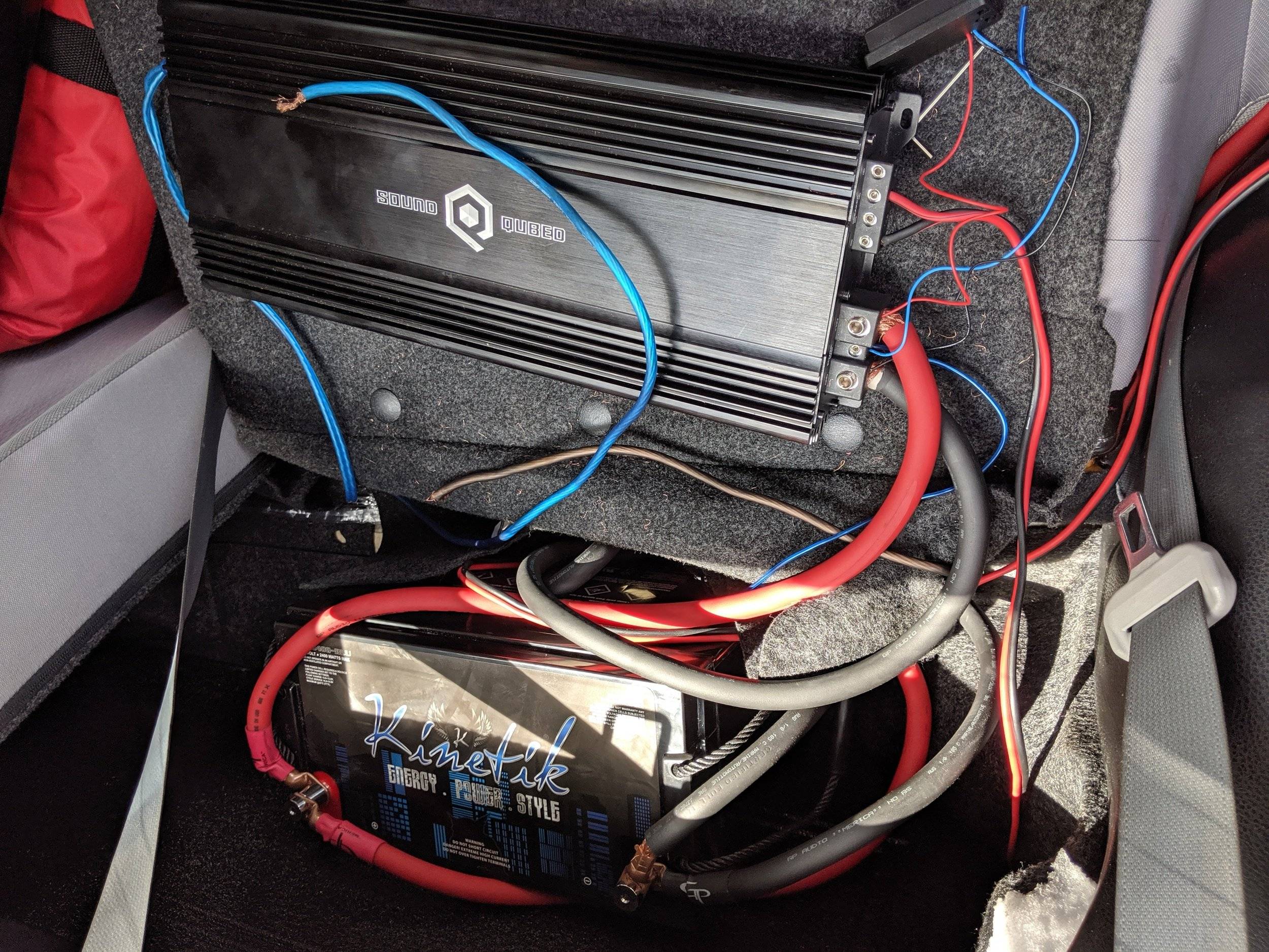

First ever install finished kinda 13.0v's
danielbea122
CarAudio.com Exclusive
I couldn't have done it without this forum thanks to everyone.
18084
Looks like crap I know but I just wanted to get everything hooked up to see if I will need the HO alt
The little SQ voltage meter was staying at 13.3 - 13.5 with a/c and headlights on idling
18085
Guess I'm buying an alternator
Update after realizing the kinetik brand battery terminals do not tighten well, I had to replace them with marine terminals. Problem is that after getting a good connection my voltage dropped to 12.9-13.0 idling.
Still have to do the big 3 in the morning after car cools down completely but probably just going to order the alternator.
13v is totally fine. You have a 2nd battery and you aren't even using it until you drop below 13v. If you never plan on going above this power level, 12v+ is a-ok and spending money on an alt is not worth it. Just beat on it and if the alt dies, then replace it. A single bank of caps would do more for your voltage than an alternator (for the price).
Good job hooking the voltmeter up to the amp input terminals. Make sure you calibrate it with a DMM if it has a calibration potentiometer

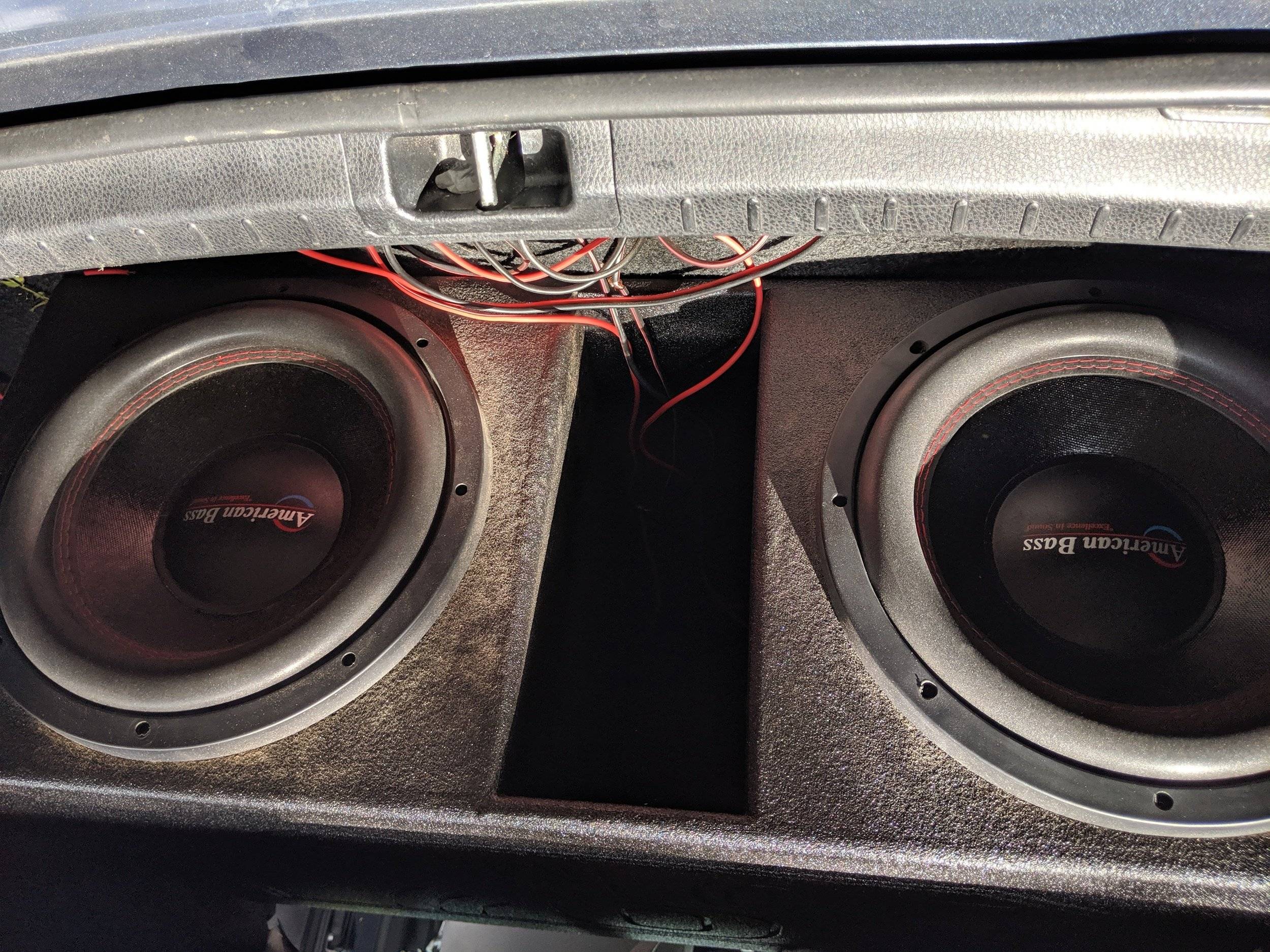

Amp says it takes 14.4v for 2200w rms
Right now it's barely pushing the speakers. My single sa12 was way louder than these 2 American bass xfl 12s

It's not loud because you're barely getting 1kw due to rise. If you want it to be louder you need to get something like the Taramps MD5k. Your box may also be the problem, on top of the trunk. You won't notice much of a difference in loudness with an alternator. That's just not how it works.
I'd sell the amp and battery, get a Taramps MD5k, and a bank or two of caps, if you want it to be audibly louder.
If you can wire to .5, get a bass 3k or bass 5k

You can do that too. You just won't be getting much power out of that amp after rise. Changing the orientation of your box in your trunk is another think you need to try. Or is it a suv, can't tell
XFL12's have a 3 inch coil afaik. You need a solid 1.5kw per sub to get their peak output
Err are those HD's not xfl?
It's a Toyota Corolla lol can't really move the box much. I can face the speaker towards me.
Probably should mention the speakers are brand new so after a little break in and flipping the box around I'll start giving it some gain. See how it sounds.
I gave them about 20% gain didn't wanna go to hard.

Finished big 3 and now it's staying 13.5v and thumpin without any fluctuations in the voltage
Cleaned up some of the ground connections as well
