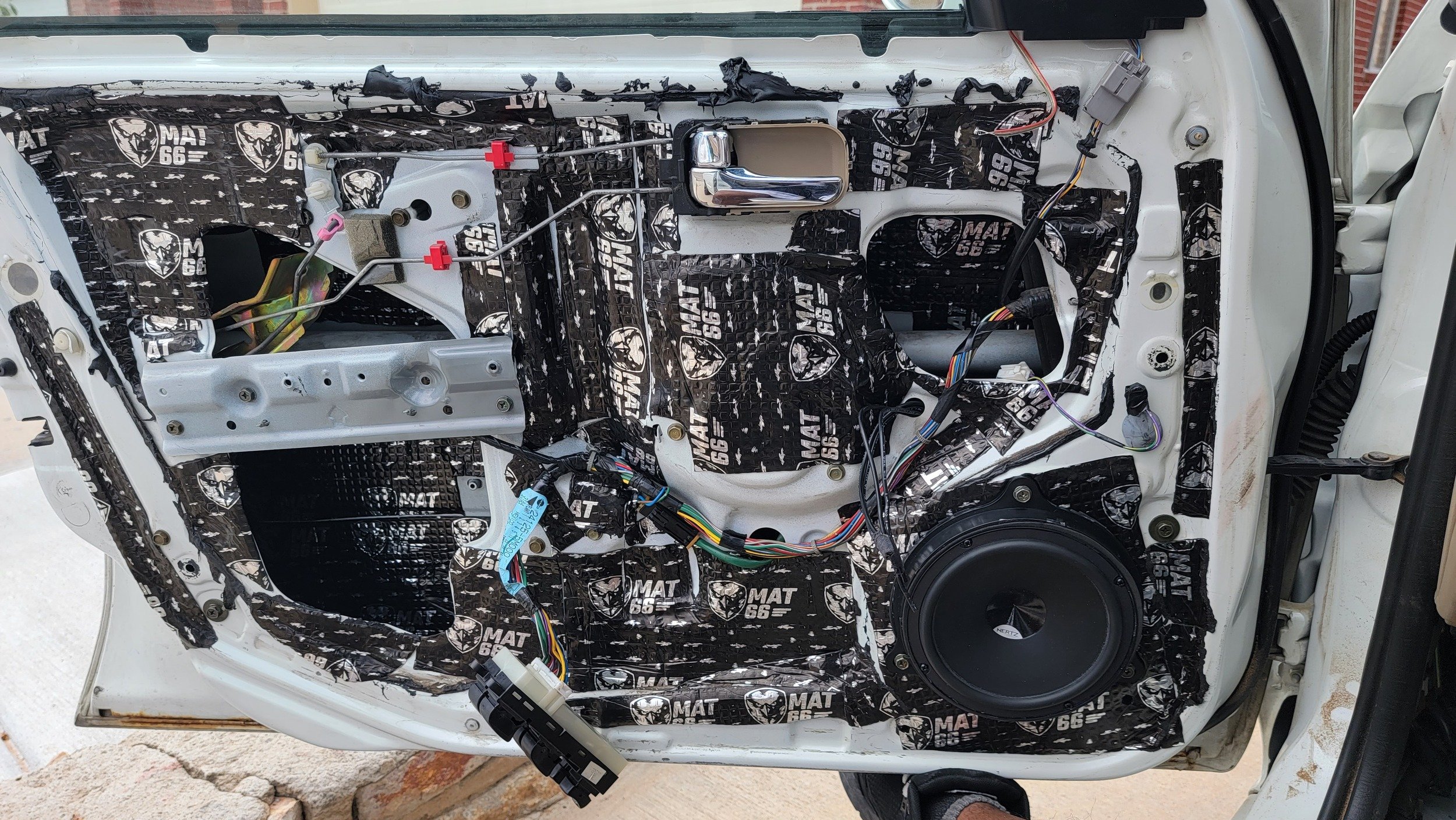

Finishing the passenger side door:
Today my door adapters finally arrived so instead of putting the carpet in like I was supposed to I decided to sound deaden and mount the speakers into the passenger side door.
Here's some pictures of the Hertz mid bass compared to the factory one that came out of the door:
I can tell that they're going to make a huge difference in the quality and the loudness of the front stage.
This time I remembered to add sound deadening to the inside sheet metal as well as the actual door frame. I didn't cover the entire door as I did with the passengers. What I actually did this time was I made sure to address any flat areas without any bends that would create vibration.
I also remembered to add sound deadening around the mounting point for the speaker adapter and the speaker gaskets to prevent unnecessary noise.
When I put the door back together and found that everything fit perfectly with no issue I was pretty stoked. It's kind of nice to see a 6 month plan begin to coalesce into the final product and have it come out super close to what your original vision was.

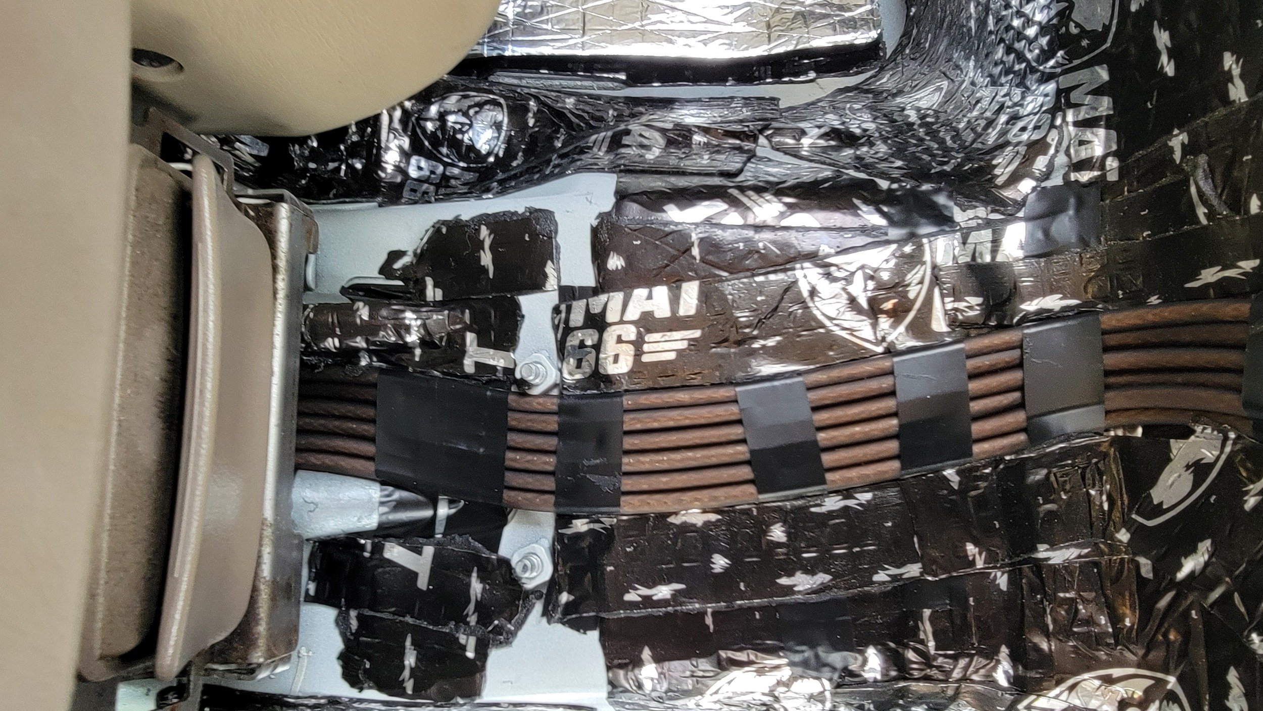

Completing wiring and the driver side door:
I completed the sound deadening on the driver side door and the component set fit perfectly on that side as well

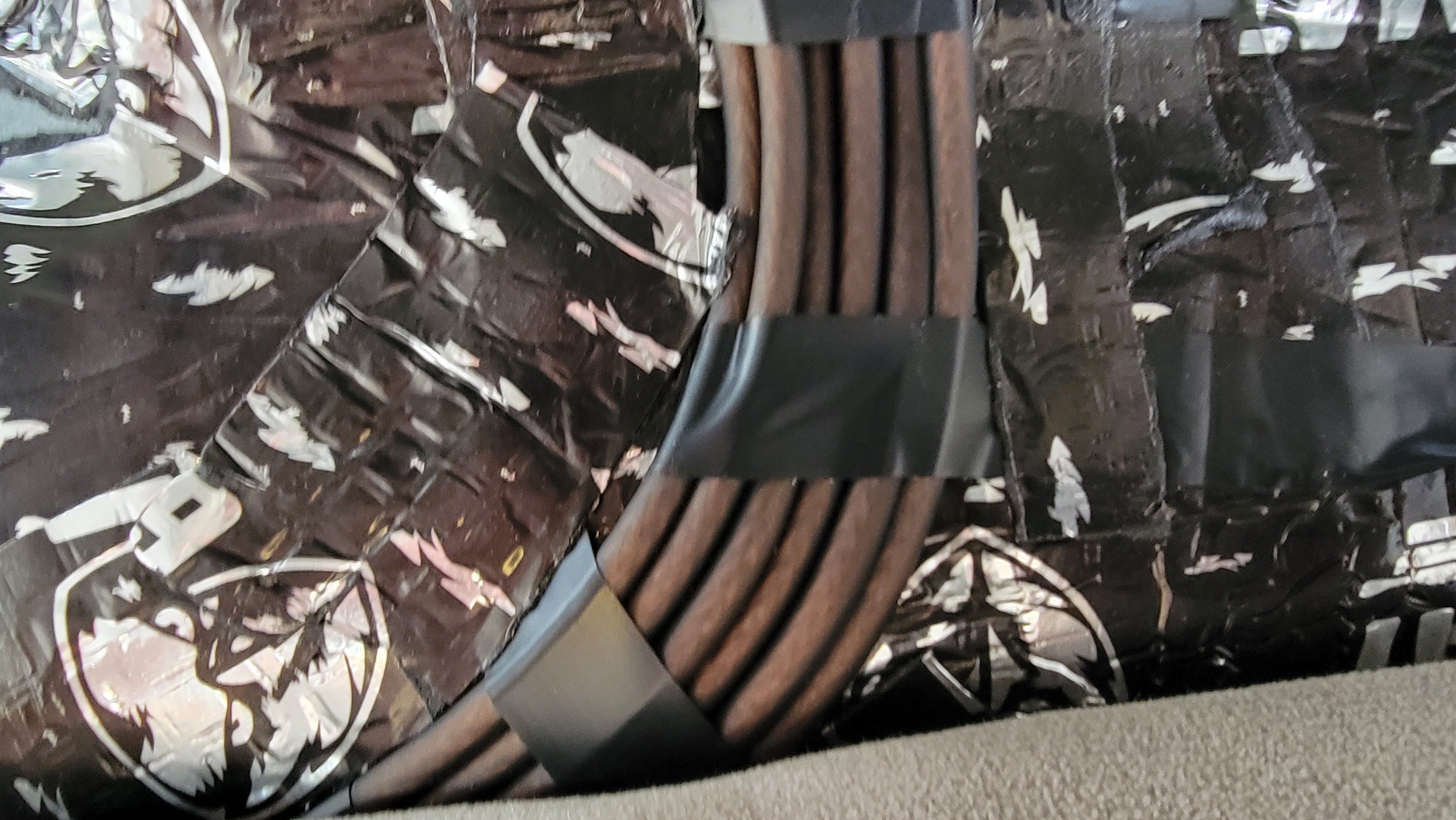

I also ran RCA cables beneath the center console to the back of the car as well
20220816_152100.jpg20220816_152050.jpgView attachment 41669View attachment 41670
Once I was done I realized that I messed up pretty badly because I did not label the RCA jacks at all. But it took me 2 hours to run down as neatly as I did and to make them fit perfectly beneath the console so I'm definitely not going to undo that to figure out which one is which.
I am however very open to options as to how I can sort them out without having to redo everything over again. Right now I'm going with plug one into the receiver and test them for signal one by one.
Any better ideas?

Use a long wire with an alligator clip and test continuity buy attaching the alligator clip to the positive post of the rca plug and the other end of the wire to the multimeter. Then with the remaining probe find the matching rca by touching the positive post on the other end.
Your just making a long set of test probes

So I thought about it and I realized that with the little deductive reasoning I actually only needed to test two of the RCA's and from that I can figure out what all of them were so once I did it it only took like 5 minutes.
