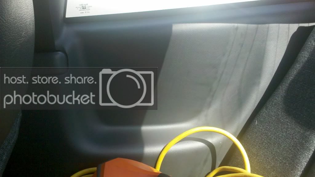

This is the spot in the back seats on the side-wall where I'm gonna put one of the 7" and another in the opposite side.

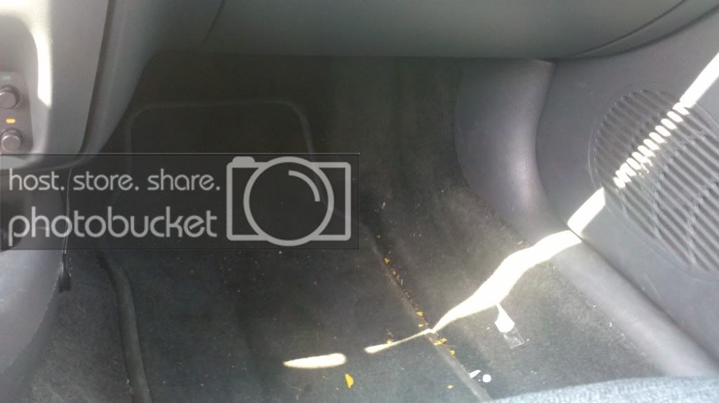

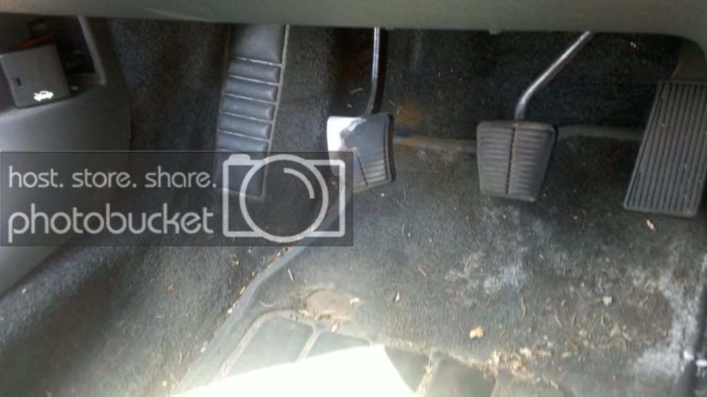

These are the front floors was thinking just a small fiberglass enclosure somewhere on the floor, but theres not much room especially b/cuz it's a manual and I got a clutch in there.

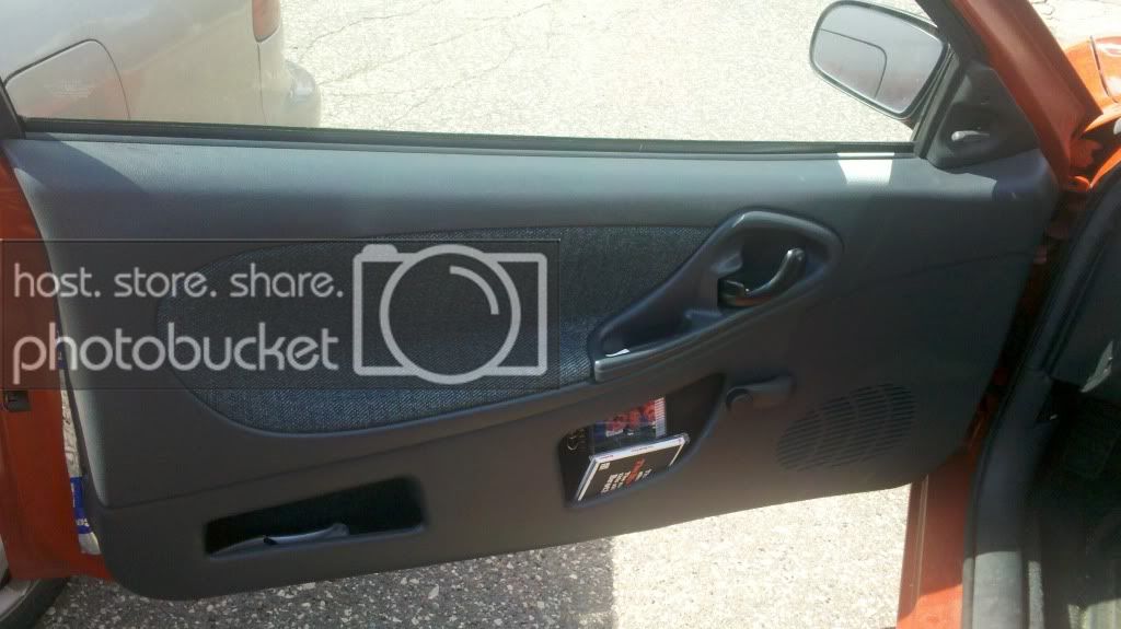

This is the door panel. There is a driver in the stock speaker placement I'm thinking maybe room If I cut into the plastic at the rear portion of the door panel maybe...
Manual or not, you can make kicks for the mid bass. I had a 99 z24 and had Q-form kicks which housed a 6 1/2" mid and 1" tweet. Also did a custom kick after that as I didnt care for the Q-forms and fit fine. Just have to measure twice, cut once. //content.invisioncic.com/y282845/emoticons/wink.gif.608e3ea05f1a9f98611af0861652f8fb.gif
Now fitting the 7" in stock speaker location may be tricky. Could always fiberglass the bottom half of door if you know what you are doing, but that is some time.
